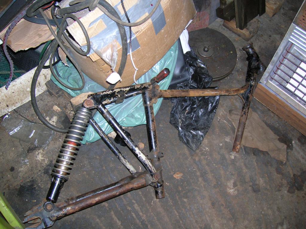

bantamsam Posted July 27, 2013 Report Share Posted July 27, 2013 Hi Dan Im a fellow Yorkshire lad myself and my cub frame has already been chopped about like your thinking of doing and it looks alright to me i have a rolling frame at the moment and it has massive ground clearance would you like to see a photo? Cheers Sam Quote Link to comment Share on other sites More sharing options...
danw43 Posted July 29, 2013 Author Report Share Posted July 29, 2013 Yes please,that would be great and would be much appreciated. regards Dan Quote Link to comment Share on other sites More sharing options...
bantamsam Posted July 29, 2013 Report Share Posted July 29, 2013 Quote Link to comment Share on other sites More sharing options...
bantamsam Posted July 29, 2013 Report Share Posted July 29, 2013 That was before i painted it however i cant seem to upload the other photo of it painted? This may of worked Quote Link to comment Share on other sites More sharing options...
danw43 Posted July 29, 2013 Author Report Share Posted July 29, 2013 (edited) so does it only have two mountings for the engine,on the frame?And how does the bash plate attach? Edited July 29, 2013 by danw43 Quote Link to comment Share on other sites More sharing options...
bantamsam Posted July 30, 2013 Report Share Posted July 30, 2013 Yeah only 2 mountings! And i am going to make a bash plate out of a sheet of alloy that im getting from rufforth this weekend.I will probably attach it to the downtube with some sort of U clip and attach it to the rear somehow. Hope this helps a bit, hopefully i will have it done in a couple of weeks so i will upload a pic of bashplate once finished. Cheers Sam Quote Link to comment Share on other sites More sharing options...
