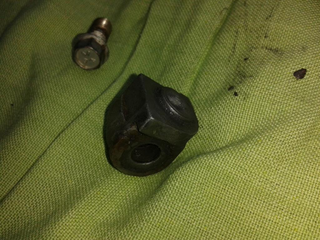

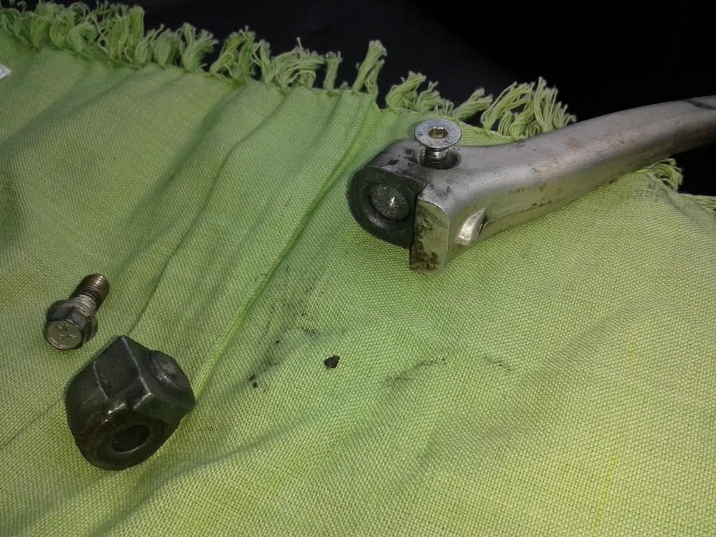

danhar707 Posted July 10, 2013 Report Share Posted July 10, 2013 I'm in for the Reeth 3day trial starting next Fri (19th) and this Sun the kickstart snapped on my bike (2008 Rev4T). I called Lampkins on Monday and they sent a new lever+joint part, arrived Tues, offered it up last night and doesn't fit! Called Lampkins today and they conclude I must have an 'early 08' which has a bad/obsolete design of kickstart (lots of forum posts relating to the probs with this older design.) The newer lever they sent is not compatible with the older shaft on my bike and I'm told the only way forward is to buy a kit (lever + shaft) which upgrades my bike to the later spec. Problem is they don't have a kit in stock (nor the shaft on its own.) Need to be ordered from Italy and they say would not get to me until Fri next week, which is going to be too late! Or I can pay a fortune for a one-off shipment - est. £50, which would bring the bill to an eye-watering £200; just too much to take right now! Does anyone have any better ideas? I've tried BVM. Incase you're wondering...the broken bits are quite beyond repair. See attached pic - i.e. snapped at base of 'stub' Quote Link to comment Share on other sites More sharing options...
danhar707 Posted July 10, 2013 Author Report Share Posted July 10, 2013 Trying again with the pics. Note the close up of the base.... see how previous owner of bike grafted in a collet to make the kickstart lever sit a little further outboard and thus get round the problem of the old/bad design fouling the frame. I would do the same again myself, but the old parts are no longer available!!! Quote Link to comment Share on other sites More sharing options...
