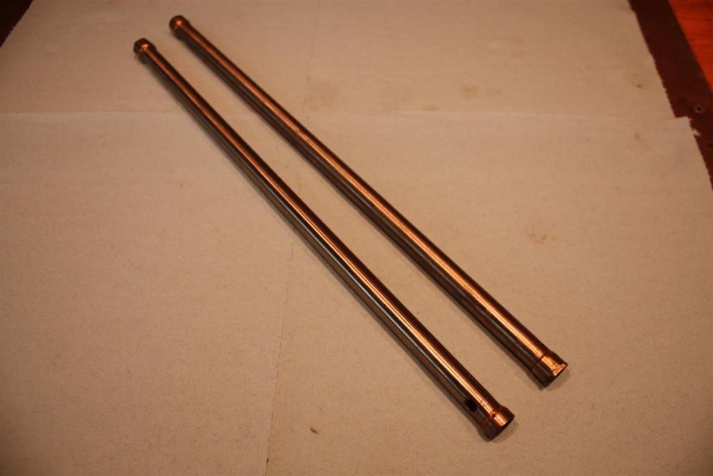

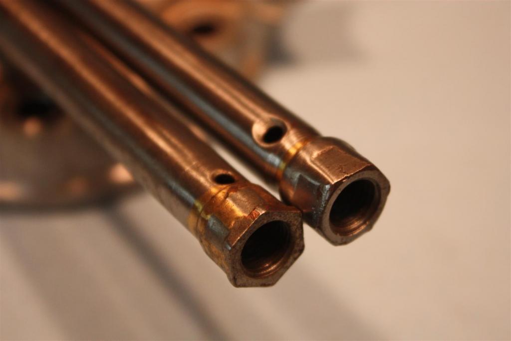

What's the bleed tool for?
I made these tools for bleeding cartridges in forks. They have different thread sizes to fit a variety of cartridge rods. The tool is threaded to the top of the rod and then the cartridge can be stroked to purge air. The tool also makes it easier to pull out the cartridge rod to install the top cap.
