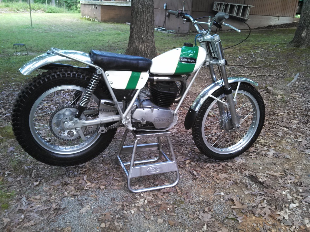

hotshoe63 Posted July 19, 2013 Report Share Posted July 19, 2013 (edited) Well, for anyone interested, I have made considerable progress. I did get my bash plate / bolt up issue solved, at least until I bash it but for now seems to be goot-n-tight and as I mentioned in my previous post, I did put som neoprene rubber between the plate and engine cases to act as a vibration damper. Now there was one other thing I did but, not going to get into that on the grounds this it my make me look pretty stupid. At any rate after the addition of the neoprene the thing runs/sounds like a Rolex! It is so quite and smooth. I have to admit that I was astonished. It had been SO LOUD and buzzy before, easily give my CZ a run racket wise. Now it just purrs. So, between my front yard and backyard I puttered around about six short sections...what a tractor! Now chaning the fork oil and going to a friend's place tomorrow morning. About 5 miles from my house, he has 15 acres and says I can help myself to any of it I like...WOOOO-HOOOO!!! Edited July 19, 2013 by hotshoe63 Quote Link to comment Share on other sites More sharing options...
nelly1 Posted July 19, 2013 Report Share Posted July 19, 2013 dont drop it mate a dented tank will break your heart Quote Link to comment Share on other sites More sharing options...
lineaway Posted July 20, 2013 Report Share Posted July 20, 2013 So is the wiring still under the engine? Need to move it before you short out the stator. Quote Link to comment Share on other sites More sharing options...
hotshoe63 Posted July 20, 2013 Author Report Share Posted July 20, 2013 Good points...both of them. Yeah, I don;t know that this tank is gonna dent. It will do the Humpty-Dumpty thing and that will be it. I'm a novice and "plan" to ride accordingly. Wiring...hummm, I'll address that before I load up. I'll cut a channel in the neptrene and try to insulate the wiring. Quote Link to comment Share on other sites More sharing options...
lineaway Posted July 20, 2013 Report Share Posted July 20, 2013 No, drill a new hole coming out of the case along the front frame. Sorry you will need a flywheel puller. That stator was expensive when I was 14. Quote Link to comment Share on other sites More sharing options...
