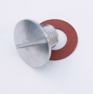

p@ul250 Posted July 21, 2013 Report Share Posted July 21, 2013 No your Bulto 151 should have a plain filler plug like this one Quote Link to comment Share on other sites More sharing options...
davdeborg Posted July 21, 2013 Author Report Share Posted July 21, 2013 On 7/21/2013 at 7:15 PM, p@ul250 said: No your Bulto 151 should have a plain filler plug like this one that's what I got paul so is there no breather for the gearbox then anywhere cheers Quote Link to comment Share on other sites More sharing options...
