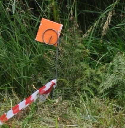

p@ul250 Posted July 22, 2013 Report Share Posted July 22, 2013 (edited) We make our own for the club. From a country/farm store you will need a roll of fencing wire(can be got for about £10.00). Then get an old round chair/table leg about 1.5" O/D and saw a slot in one end about an inch deep. Cut wire into lengths of about 18">20" long. place wooden leg in a vise and pop end of wire in slot. Now bend wire round one and three quarter turns. You have a safe wire with no sharp point. Now use coloured card or plastic cut into squares about 2.5" slip between the turns of the wire! You have a Marker. Now make about 400 and you have enough for a trial. I usually take about twenty when going for a practice! Edited July 22, 2013 by p@ul250 Quote Link to comment Share on other sites More sharing options...
