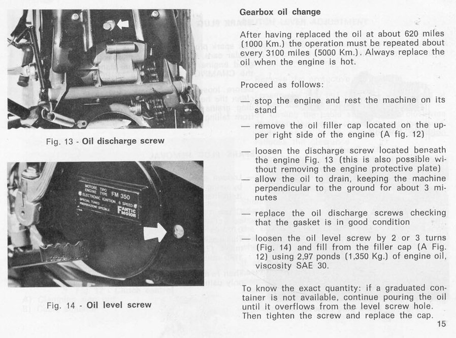

steve fracy Posted July 24, 2013 Report Share Posted July 24, 2013 Where is the drain plug for trans oil??? Quote Link to comment Share on other sites More sharing options...
fantic303 Posted July 24, 2013 Report Share Posted July 24, 2013 Where is the drain plug for trans oil??? Quote Link to comment Share on other sites More sharing options...
axulsuv Posted July 24, 2013 Report Share Posted July 24, 2013 !!! And I was just gonna say on the engine !!! Glenn Quote Link to comment Share on other sites More sharing options...
totalshell Posted July 24, 2013 Report Share Posted July 24, 2013 what is 1.350kg of oil? Quote Link to comment Share on other sites More sharing options...
steve fracy Posted July 24, 2013 Author Report Share Posted July 24, 2013 Thanks 303, obviously my skidplate is not stock....no hole for that plug, will remove skidplate and drill hole in it at same time! Great pics must be the original manual? Steve Quote Link to comment Share on other sites More sharing options...
0007 Posted July 25, 2013 Report Share Posted July 25, 2013 Don't worry about it Steve It's gonna take you forever to put 5000km on that thing Quote Link to comment Share on other sites More sharing options...
