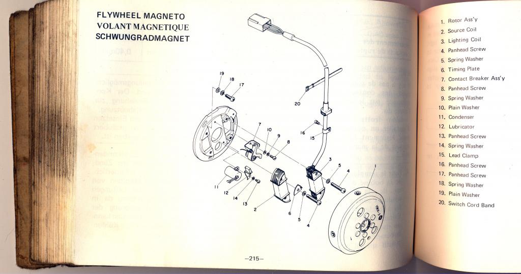

nicbrrghs Posted August 3, 2013 Author Report Share Posted August 3, 2013 That sounds quite logical as my son dropped some of the washers off the points and i just replaced, didnt think of what order they went in. I will look today and try and check but difficult knowing what order they go in now they have been off. Thanks Quote Link to comment Share on other sites More sharing options...
kee Posted August 3, 2013 Report Share Posted August 3, 2013 this is from a ty250 1977 but could be the directions you need. Quote Link to comment Share on other sites More sharing options...
old trials fanatic Posted August 3, 2013 Report Share Posted August 3, 2013 (edited) if I remember right the washers might be insulating ones. Best to check. Edited August 3, 2013 by old trials fanatic Quote Link to comment Share on other sites More sharing options...
