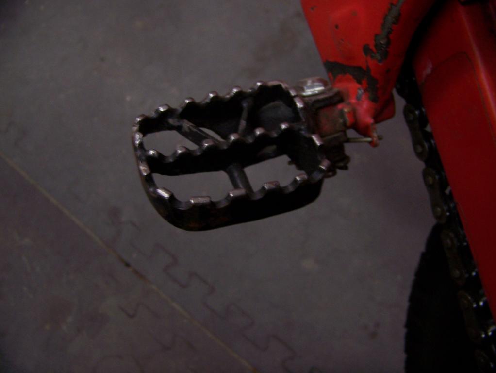

westymono Posted March 29, 2014 Report Share Posted March 29, 2014 Hi, i have 2 ty monos and the 84 model has had the peg mounts cut off and plate steel welded over to enable modern peg mounts to be fitted .At the time of buying the bike,it was also fitted with low renthal bars and i found the riding position odd so i fitted a pair of 6 inch rise renthal bars and this transformed the bike and i ride it better than my previous gasgas 250 and 280 bikes ( i am a 47 year old clubman rider and do not need the power and agility of a modern machine) If you choose to have the footrests altered,be mindful of the rear brake position also as this may need moving/altering also and make sure the footrests are welded at exactly the same height as each other or you will have the bike/yourself out of balance if one is a touch higher than the other. My other ty is an 85 model that has standard pegs. I purchased a pair of steel serrated strips (selling on ebay for aprox £7) these have been manufactured as so to be bent around and welded to your existing ones to make them fatter and a good tip is to have the serrated strip bent to the size and shape of a modern fat peg and then weld the now bent serrated strip directly to the front of the existing peg,you will then have a gap to fill from the rear of the existing peg to the back of the new peg,weld in some steel plate,nuts or whatever to bridge the gap. The pegs now feel like a modern pair and dont make your feet ache and although have not been lowered,do allow you to move your weight back to the rear of the now fatter pegs. Once used to it after getting off of my other bike,i ride just as well but i would say the change in handlebar height was a massive help, if you are tall as i am,you feel less tired and more comfortable but without doubt feel that the combination of lowered pegs and higher bars gives a much better handling bike,hope this helps,Steve Quote Link to comment Share on other sites More sharing options...
jse Posted March 31, 2014 Report Share Posted March 31, 2014 Here's what they mean by adding the strip. These have over 20 years of hard use with no problems. Jon Quote Link to comment Share on other sites More sharing options...
