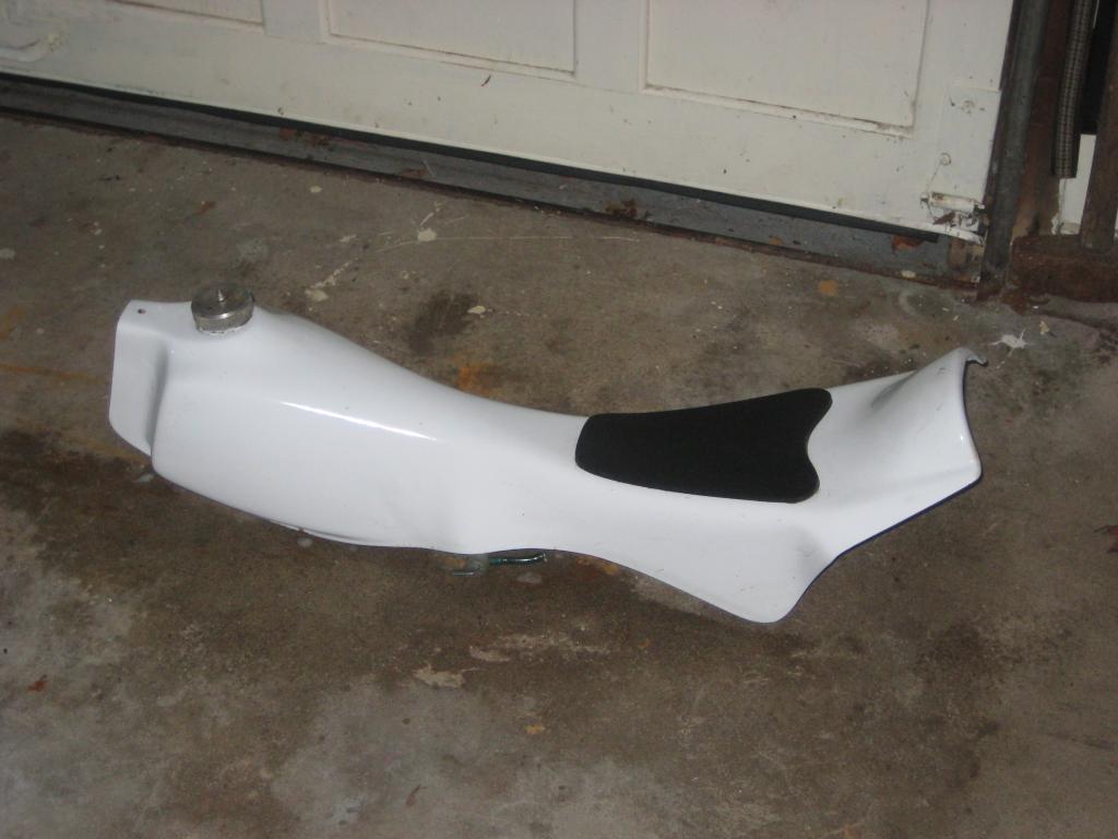

hoboarchery Posted September 16, 2013 Report Share Posted September 16, 2013 I bought another 86 Honda TLR 200 yesterday and it came with a tank seat combo. The frame had been cut so it won't accept the stock tank anymore. The guy tells me that he sat on the seat and it started leaking only had it 5 hours, back in 2009. I am guessing it wasn't installed properly so I would like details on the process too if it can be repaired. It has paint missing on the bottom side where it touches the frame. It is all white but shows red underneath where it looks to be pealing. The seat area is a rough cut fiberglass and looks different than the tank which is smooth. I have done fiberglass repairs before to a canoe, but worry that the gas is eating the tank. There is also a bubble on the side. Maybe bubble is the wrong word, but it is raised and not smooth. It isn't soft though. Thanks Tom Quote Link to comment Share on other sites More sharing options...
hoboarchery Posted September 16, 2013 Author Report Share Posted September 16, 2013 sorry here is the picture Quote Link to comment Share on other sites More sharing options...
bestrcpilot Posted September 16, 2013 Report Share Posted September 16, 2013 This is what I do. Fix the crack using a exopy from the hobby shop, the kind that is used on RC airplanes and fiberglass cloth. Then coat the inside with Caswell tank sealer. Never leave gas in the tank always drain the tank after a ride and never use a one way value on the vent line. Still using a SM tank I fixed this way for 4 years now Quote Link to comment Share on other sites More sharing options...
hoboarchery Posted September 16, 2013 Author Report Share Posted September 16, 2013 Great any tips on mounting it? Can you use the seat at all on these? Quote Link to comment Share on other sites More sharing options...
bestrcpilot Posted September 17, 2013 Report Share Posted September 17, 2013 My tank is on a Yamaha. But looking at your tank I would say that the front mounts like a Bultaco tank/seat does.. And the back with a couple of bolts to the rear fender. And yes you can use the seat if it sits on the frame rails Quote Link to comment Share on other sites More sharing options...
charlie chitlins Posted September 17, 2013 Report Share Posted September 17, 2013 You shouldn't have to drain the tank after each ride if you use ethanol free fuel. Ethanol will turn your fiberglass to snot. Quote Link to comment Share on other sites More sharing options...
hoboarchery Posted September 17, 2013 Author Report Share Posted September 17, 2013 Thanks guys, I have been using pump gas, super unleaded, I think it is 10% Ethanol, I can drain it after. Quote Link to comment Share on other sites More sharing options...
charlie chitlins Posted September 18, 2013 Report Share Posted September 18, 2013 There's a website...I think it's realgas.com...thst lists stations in your area that have alcohol free gas. I use avgas from the local airport...100 octane. The bikes love it and it doesn't smell! Quote Link to comment Share on other sites More sharing options...
wfo speedracer Posted January 13, 2014 Report Share Posted January 13, 2014 Epoxy does not work so well with fuel, vinyl ester which is epoxy modified polyester resin is the stuff you want to use, as stated before you need to find non ethanol fuel and coat the inside of the tank. the avgas suggestion is a very good one if you don't ride a lot , that fuel stays good for 10 years ! Quote Link to comment Share on other sites More sharing options...
