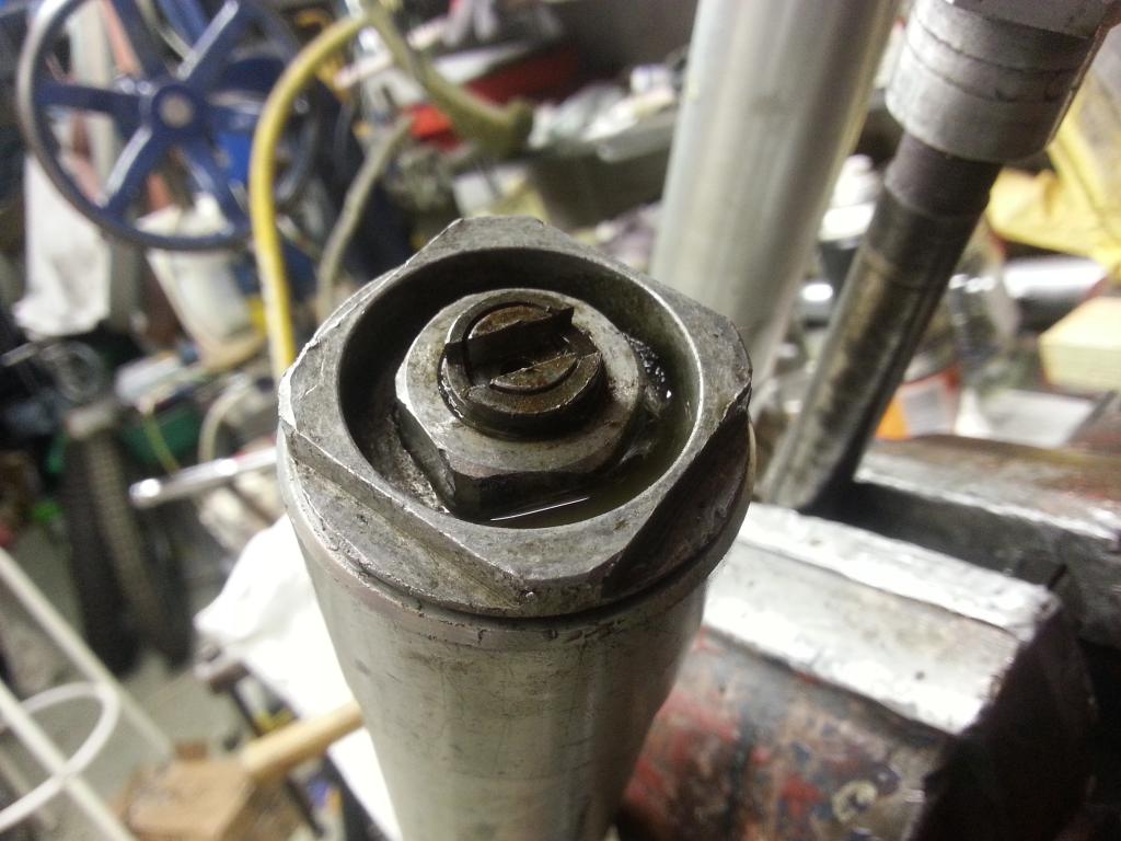

hyfan Posted September 17, 2013 Report Share Posted September 17, 2013 Hi im new to the forum.I have an early Gass Gas Gt320 1991 and im trying to disassemble the top end of my upside down paloma front forks(in order to remove slidind leg to fit new oil seals) .Does anyone know how to remove the aluminium top cap (shown in attached picture) to part it from the internal damper rod.I have removed the small brass adjusting knob shown in second photo but dont know what to undo next.There appears to be a steel tube which goes up into the fork head cap.I have unscrewed the cap from the leg and there is like an aluminium tube with a coned lower wnd which can be seen over the damper rod. So i just need to find out how the aluminium cap discinnects fom the damper rod.Once i get the cap off Iassume ill be able to pull the slider out the bottom of the fork leg to gain access to the seal ?.Any advice will be much appreciated.Thanks Hyfan Quote Link to comment Share on other sites More sharing options...
lineaway Posted September 17, 2013 Report Share Posted September 17, 2013 (edited) www.trialspartsusa.com/tech.html has a suspension break down. Looks like you just remove bottom leg bolt, then cap and rod assembly just pulls out. Edited September 17, 2013 by lineaway Quote Link to comment Share on other sites More sharing options...
hyfan Posted September 17, 2013 Author Report Share Posted September 17, 2013 Hi lineway thanks for the advice ive identified the diagram .As you quite rightly day the cap can be seen as a seperate part.still not 100% if it screws of the rod using a 17mm spanner on the hex on the cap top and holding the damper rod some how...Any other thoughts guys... Quote Link to comment Share on other sites More sharing options...
