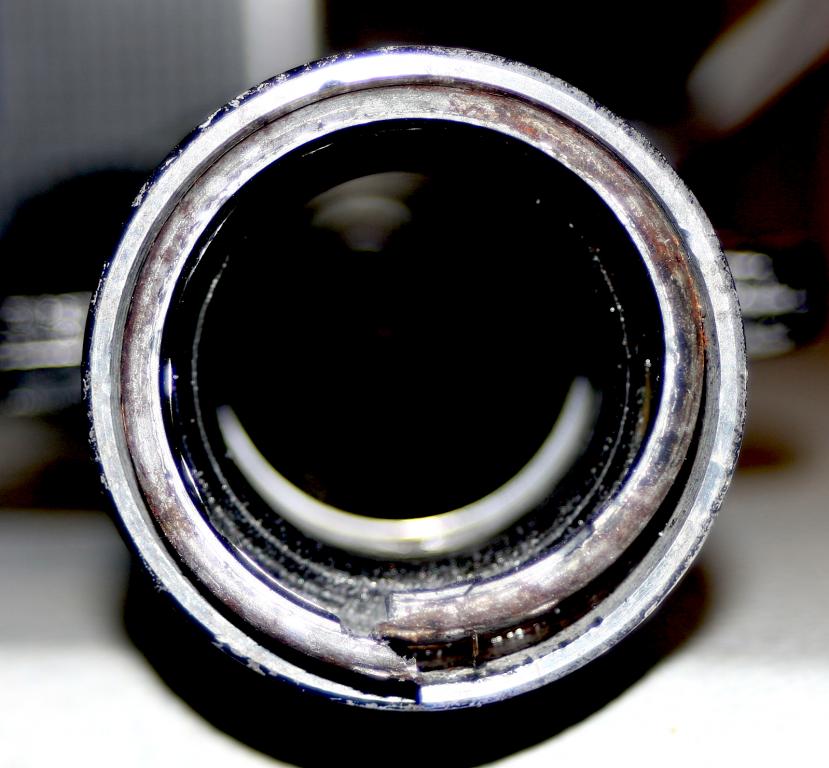

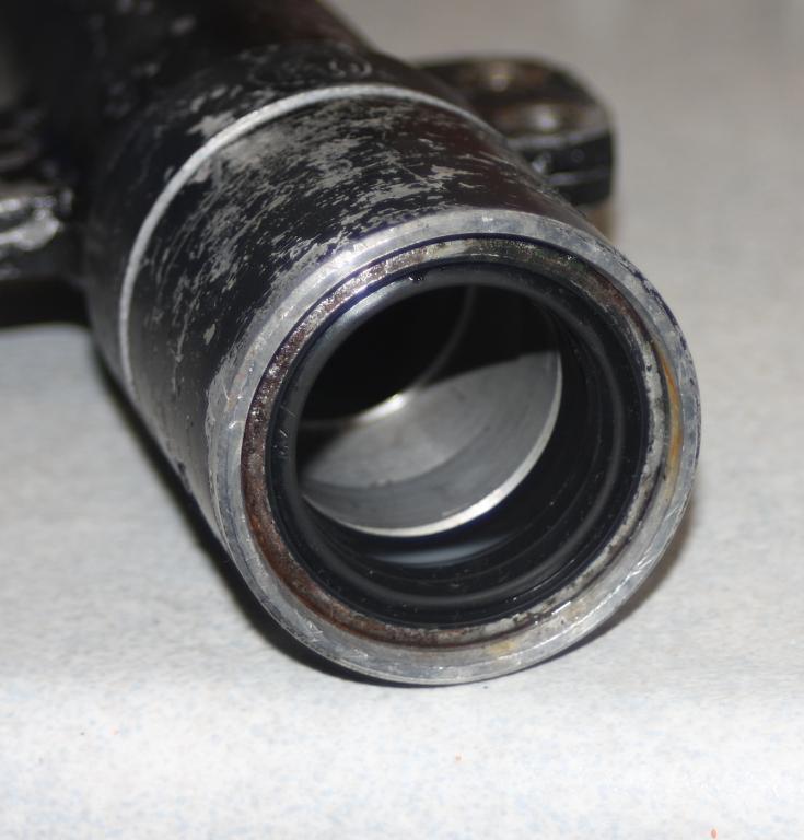

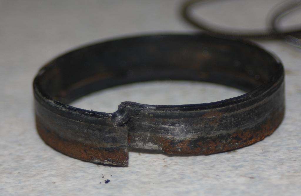

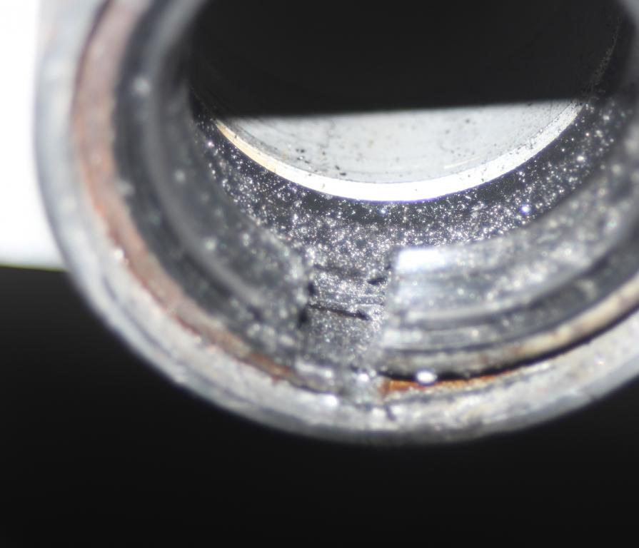

gregr Posted September 26, 2013 Report Share Posted September 26, 2013 Just to confirm that taking a dremel {or similar} to the side wall of the seal works great ! Did all four in my legs in under 30mins + tea break . I did however cut / peel as much of the rubber seal as possible. Thanks to who ever suggested it . Heres a few images . Cheers Greg Quote Link to comment Share on other sites More sharing options...

gregr Posted September 27, 2013 Author Report Share Posted September 27, 2013 There is no point Monty , other than I do not own a fork seal puller but I do own a dremel , had 1/2hr to kill and did'nt damage the legs either ... just another way of achieving the same result ! 1 Quote Link to comment Share on other sites More sharing options...
