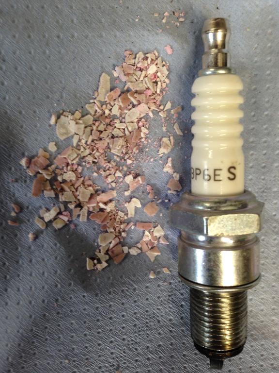

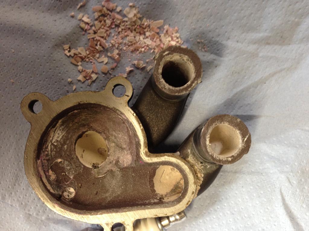

southwester Posted October 9, 2013 Author Report Share Posted October 9, 2013 That stuff's a reaction between different coolants is it? makes sense, I couldn't figure out how it got there I wondered if it was rad weld or something. It seems to have coated the parts of the cooling system and there were clumps of it within rubber hoses and actually there were some lumps in cylinder. I've submerged the water pump cover in petrol and fairy liquid so far to try and dissolve it to no avail but I dropped a flek of it in some watered down spirt of salts and that dissolves it pretty quick but it says on the tin not to use it on aluminium so I need to find something Ali friendly that I can rely on to clean waterways in rad with out visual inspection. Would you or anyone else have any suggestions how to shift it? As for replacing main bearings and seals I can't detect any play through fly wheel and there isn't any oil leaking through seal behind fly wheel by the look of it but when I took sump guard of the bottom of bike i noticed a lot of oil over the bottom of the engine and the rubber matt the engine sits on which made me wonder if the crank case seals were leaking oil, I just got the vibe it wasn't from where the oil has been drained off previous. Also the coating on engine cases had bubbled where the cases meet which I scraped off previous to pictures which suggests to me the same and finally it looks like someone's got got the flat head out to prize the casings apart which is really making me wonder? The engine isn't off the bike yet but I'm only 3 fixings away, all comments welcome. Cheers Quote Link to comment Share on other sites More sharing options...
dadof2 Posted October 10, 2013 Report Share Posted October 10, 2013 See if your radiator tubes are clogged. I do not know anything that shifts this crud for certain. Try radflush. Run the bike with a piece of calgon (dish washer cleaner) in the system and just use water - no antifreeze. Change this regularly Try Clarkes aluminium cleaner (machine mart). Just a guess but maybe mix it 1 part cleaner to 4 parts water. If you do this don't use antifreeze and flush the system thoroughly as soon as the bike cools. Quote Link to comment Share on other sites More sharing options...
southwester Posted October 12, 2013 Author Report Share Posted October 12, 2013 I had some ds40 central heating cleaner lying around which is suitable for cleaning boilers with aly heat exchangers so I submerged rad and water pump cover in a solution of that today which has dissolved the gunk totally. The cylinders off at the re platers and I'm hoping the water ways will come back clean so I won't need to touch that. The hoses were lined with this crap but where in the past some ones got a bit heavy handed tightening the jubilee clips that part of the hose's are crushed and there's some cracking of the rubber so I am going to get a set of replacements to put on. Going back to checking the squish clearance is the technique to torque the head down with gasket in place and torque cylinder down with out a gasket kick engine over and take measurement of solder add on thickness of base gasket and that would tell you what thickness of gasket(s) to use, other wise if you install gaskets and torque down to find out your squish isn't to spec you are another Quote Link to comment Share on other sites More sharing options...
