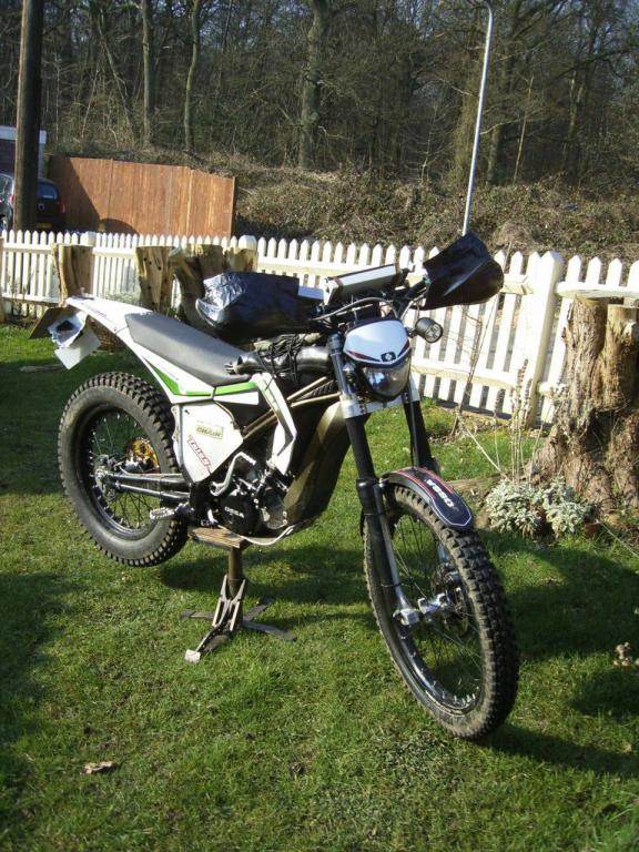

loonal Posted October 12, 2013 Report Share Posted October 12, 2013 Sounds good. Hey they do more than you think. I set mine up for an overnight long distance trial!! 1 Quote Link to comment Share on other sites More sharing options...
