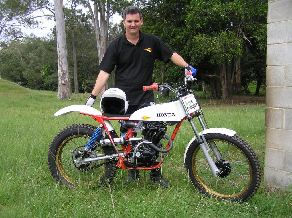

feetupfun Posted October 29, 2013 Report Share Posted October 29, 2013 The front end on this TL125 by Dan Gollagher works beautifully 2 Quote Link to comment Share on other sites More sharing options...
tlrider Posted October 29, 2013 Report Share Posted October 29, 2013 That looks great! Is it an XL125 front end? It's difficult to tell from the photo but it appears he has modified the tank to accomodate the lesser triple tree offset. Quote Link to comment Share on other sites More sharing options...

feetupfun Posted October 30, 2013 Report Share Posted October 30, 2013 I think it was MT125 front end on that one. He has a couple that are very similar. The tank was custom made by the rider to clear the fork tubes and look something like a TL125 tank 1 Quote Link to comment Share on other sites More sharing options...
montysi Posted April 16, 2020 Report Share Posted April 16, 2020 On 10/29/2013 at 10:36 AM, feetupfun said: The front end on this TL125 by Dan Gollagher works beautifully Hi. I have these forks on a TL 125 that I’m building. However the brake arm fouls on the NS fork any suggestions please ... ? many thanks Simon Quote Link to comment Share on other sites More sharing options...

stpauls Posted January 5, 2022 Report Share Posted January 5, 2022 On 10/29/2013 at 10:36 AM, feetupfun said: The front end on this TL125 by Dan Gollagher works beautifully The trees and forks in the photo are from a 1974 - 6 Honda MT Elsinore 125. Quote Link to comment Share on other sites More sharing options...
