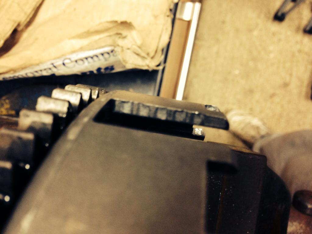

carlsmith Posted January 4, 2015 Author Report Share Posted January 4, 2015 (edited) Just before reassembly I thought I'd check the clutch basket as the clutch does stick after a week or so. Every one was the same. Hopefully it should be a lot better now I have filed them smooth. Edited January 4, 2015 by carlsmith Quote Link to comment Share on other sites More sharing options...
tony27 Posted January 5, 2015 Report Share Posted January 5, 2015 Did the bike have any engine noise when you last ran it? I replaced my basket & the rubber dampers in the gear last year & was amazed at how quiet the bike was afterwards, for what it cost I won't ever bother filing the basket as it's too easy to end up with only a few of the fingers making contact with the clutch plates Splatshop has a guide in their blog showing exactly what is involved Quote Link to comment Share on other sites More sharing options...
