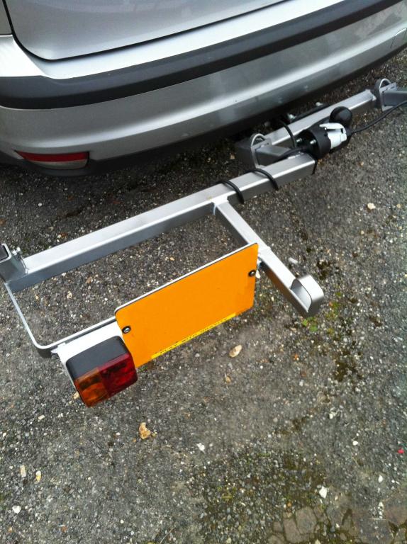

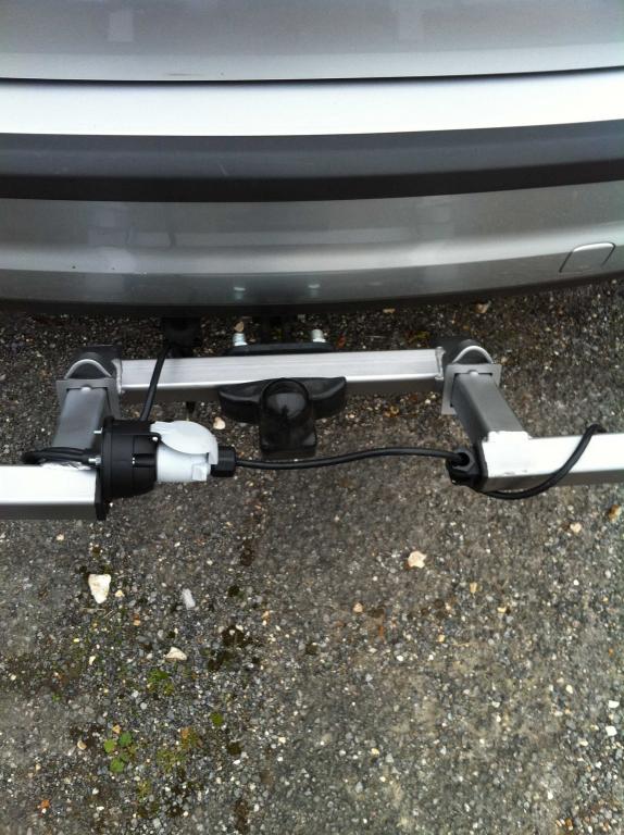

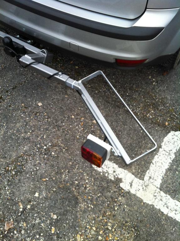

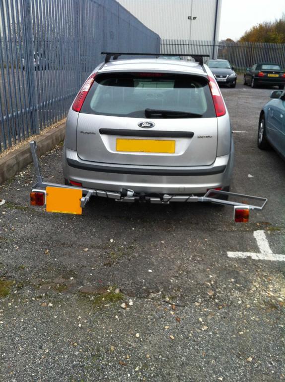

joeninety Posted December 3, 2013 Report Share Posted December 3, 2013 (edited) I just thought I'd post some piccies of the modifications I made to my standard DC rack for the lighting board. As you can see from the photos the lights and number board are all attached perminately to the rack. The off-side light has the number board illuminator blanked off so there is no visable white light from that side. The near-side lamp nicely luminates the rectangular number board. To attach all of this I got two lengths of captive nut channel used with 19" rack (electrical rack cabinets that is) equipment tack welded to the rack and then everything just bolts straight to it. With regards to the electrics the near side has a plug that plugs into the car socket, this then goes to another socket attached to the rack and then splits off for the nearside lights. The off side rack has a plug which goes to the off-side lights and this plugs into the near-side rack socket. I used a cavavan type socket and plug for this to make it error proof. I think bringing the lights to pretty much the extremity of the rack is a good thing and I don't like number boards hung from bikes and also I'm not convinced how legal a short board strapped to the rack under the bike is... Edited December 3, 2013 by joeninety 5 Quote Link to comment Share on other sites More sharing options...

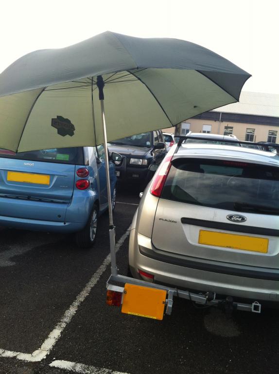

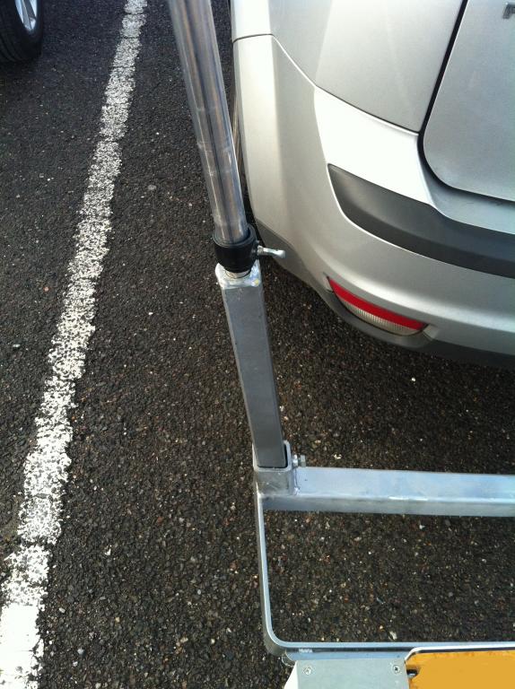

joeninety Posted January 7, 2014 Author Report Share Posted January 7, 2014 Another small mod... A hole drilled in the top of rear wheel vertical support and hey presto a fishing umbrella slides straight in! Quote Link to comment Share on other sites More sharing options...
