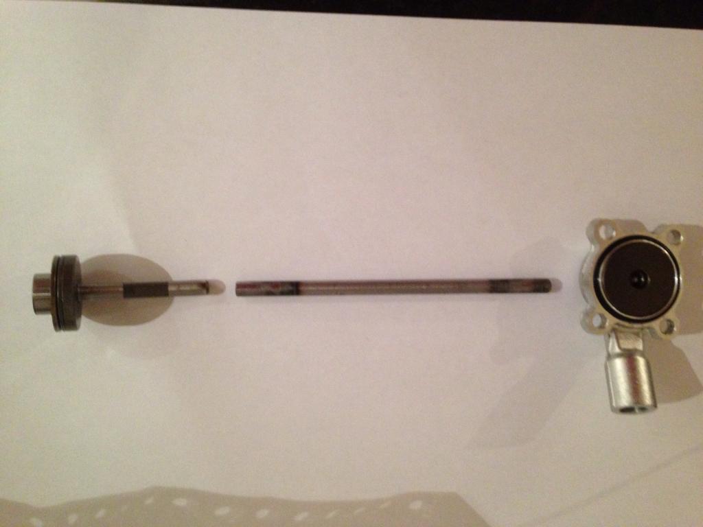

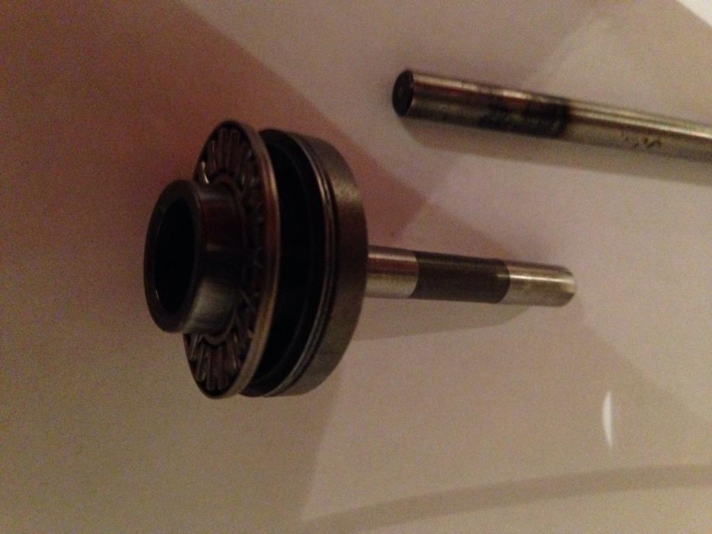

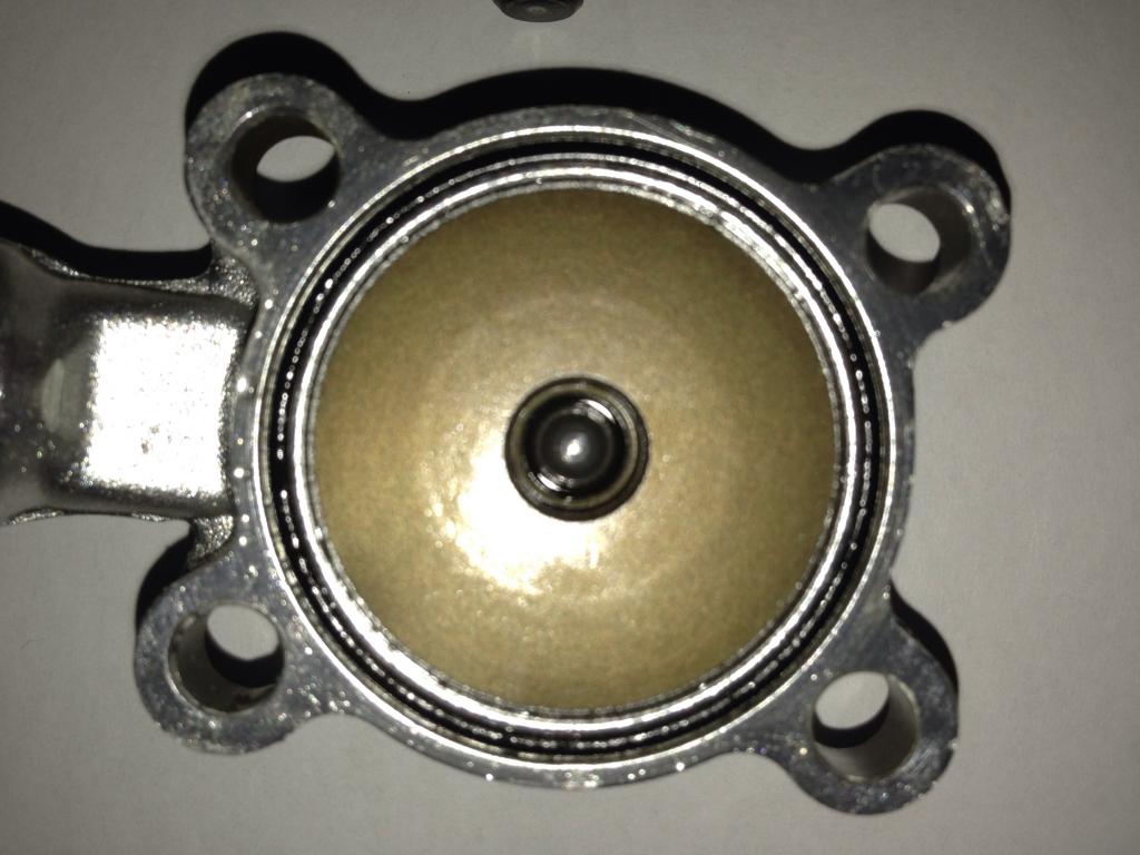

southwester Posted December 12, 2013 Author Report Share Posted December 12, 2013 This is the way I had the rods in there there's no bearing only what's in the slave cylinder. So there should be a bearing between the 2 rods? Quote Link to comment Share on other sites More sharing options...
southwester Posted December 12, 2013 Author Report Share Posted December 12, 2013 I just had a look at the motor diagram and it shows a bearing between the 2 push rods and a washer between the pressure plate and thrust bearing which I don't have on there either so this is the problem? I was pretty carefull when I took everything apart so surprised how I've lost 2 pieces! Quote Link to comment Share on other sites More sharing options...
lineaway Posted December 13, 2013 Report Share Posted December 13, 2013 No matter what brand of motorcycle, when you have two clutch push rod`s there is usually a ball bearing. Washer probably was stuck to something you did not notice. Good Luck. Quote Link to comment Share on other sites More sharing options...
