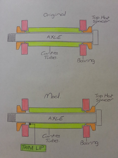

mokwepa Posted December 12, 2013 Report Share Posted December 12, 2013 Hi guys Like me, I think allot of guys have struggled to remove wheel bearings from their Beta's due to the fact that there is no lip to drift the opposite bearing out. I see that there have been a few threads about it calling for bearing pullers, welding plates etc.......here is my way. This might not be a good idea however I did spend a fair bit of time thinking about it and I cannot see any problems that could occur. I would like to hear your oppinions though. 1: Remove wheel 2: Remove top hats from both sides. 3: Use a large drift against the centre tube lip (inside the bearing) to drift the opposite bearing out only about 2 - 3mm. 4: The centre tube can now be shifted out the way and the bearings can be drifted out as normal. MOD to make future removal easier: 5: Using a drift against the centre tube lip will often damage the lip and will not allow the axle to pass through. 6: I used a belt sander (use a file or sanding block) to remove the lip on one side (see diagram) 7: assemble as normal Next time your bearings need to be changed, you now have a small lip to drift one bearing out. The centre tube is still performing its job as a spacer between the bearings inner races. Should there be some issues that I possibly over looked, please inform me and disregard this post. Regards Dylan 1 Quote Link to comment Share on other sites More sharing options...

anotherfive Posted December 12, 2013 Report Share Posted December 12, 2013 I just file a V in one end of the spacer tube just enough to be able to drift through the spacer to the opposite bearing. I think having the lip/spacer arrangement stops you side loading the bearings when tightening the axle up. Quote Link to comment Share on other sites More sharing options...
mokwepa Posted December 12, 2013 Author Report Share Posted December 12, 2013 It shouldnt side load the bearing as the top hat and the centre tube all hold the bearing sqaure when the axle nut is tightened. ?? My 07 rev3 was the exact same setup as my 13 evo. Its the only time or bike that ive come across with this setup hence the reason I thought long and hard as to why beta chose this design. Still not sure. Quote Link to comment Share on other sites More sharing options...

anotherfive Posted December 12, 2013 Report Share Posted December 12, 2013 Go for it but ............I'm not talking square and inline. If the top hats touch the lip on the centre tube then that is the final width of the setup. Remove that lip and there is a risk of side loading the bearings. Cheap anyway so you get to choose Quote Link to comment Share on other sites More sharing options...
mokwepa Posted December 12, 2013 Author Report Share Posted December 12, 2013 @ anotherfive.....ok now I get it, you mean pulling the inner race towards the other bearing. Im such a dork though......with taking that lip off, I still dont have a lip to drift the bearing out. What a idiot, cant believe I missed that Quote Link to comment Share on other sites More sharing options...
anotherfive Posted December 12, 2013 Report Share Posted December 12, 2013 yep that's right.but it could still be ok if tube without a lip is a snug fit between bearings. Put a V in it anyway and refit and try it. Quote Link to comment Share on other sites More sharing options...
mokwepa Posted December 12, 2013 Author Report Share Posted December 12, 2013 It is a very snug fit, that was my problem. Ill do a V/notch on the next change. Thanks for the help. Quote Link to comment Share on other sites More sharing options...
