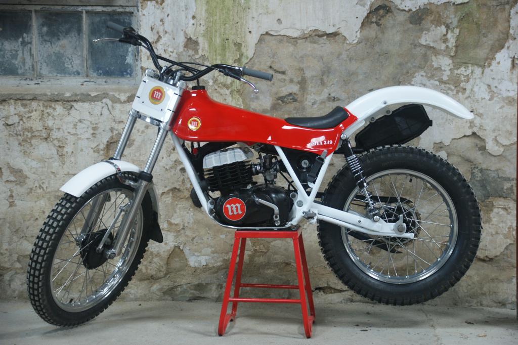

srap Posted December 12, 2013 Report Share Posted December 12, 2013 Am looking to fit my 1982 Montesa Cota 349 Mk 4 with some modern style wide footrests/footpegs. Can anyone recommend some footpegs with springs that will fit straight on to the bike with no mods required to the brackets? Many thanks. Quote Link to comment Share on other sites More sharing options...

gbmoto Posted December 13, 2013 Report Share Posted December 13, 2013 I'm using S3 footrests on my 349, they are adjustable with washers so I have them as far back and down as poss. Still not as far as my Beta but I'm happy, I don't really want both bikes to ride the same, that's why I ride a twinshock sometimes. Apologies for the Phonepic! Quote Link to comment Share on other sites More sharing options...

srap Posted December 14, 2013 Author Report Share Posted December 14, 2013 Hi gbmoto Thanks for your reply to my query about footpegs for my Montesa Cota 349 Mk 4. I like the look of the S3 pegs you showed in your photo and I just wanted to make sure that you hadn't had to alter the brackets to take these pegs. I don't want to have to cut and weld and it looks as though the S3 that you use fit straight on to the original Montesa brackets. Quote Link to comment Share on other sites More sharing options...
gbmoto Posted December 14, 2013 Report Share Posted December 14, 2013 Nice bike, same as mine but I changed the colours! No mods whatsoever to fit the S3's.......on mine anyway. Quote Link to comment Share on other sites More sharing options...
