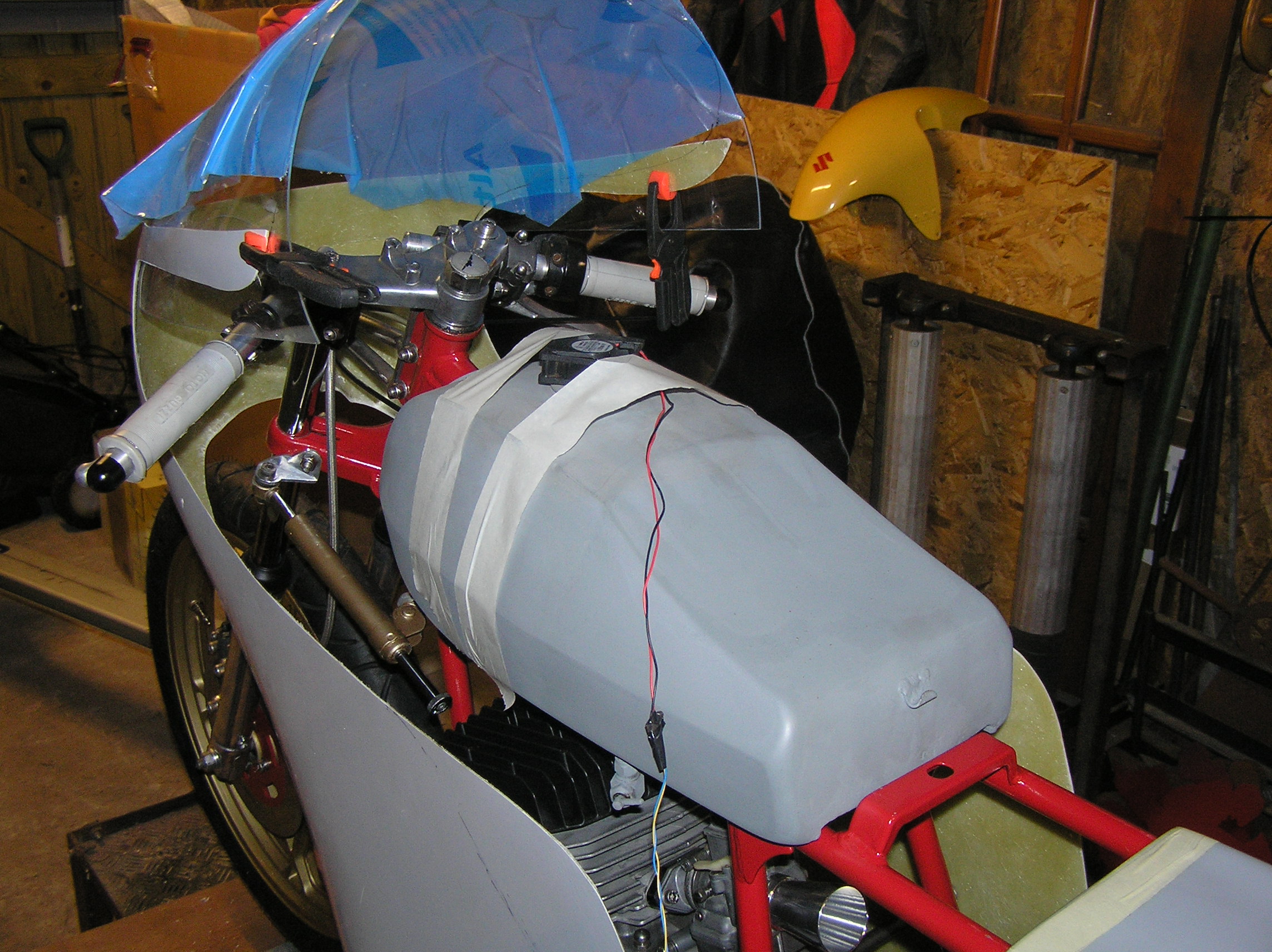

bulto58 Posted December 19, 2013 Report Share Posted December 19, 2013 Hi All , I've just repaired the fibreglass tank on my Bully after it sprung a leak. I resin coated the inside and let it cure. Having looked up some older postings on the effect of ethanol in fuel, and before i refill it, is ethanol free fuel available now, and what fuel companys supply it, if any. Quote Link to comment Share on other sites More sharing options...

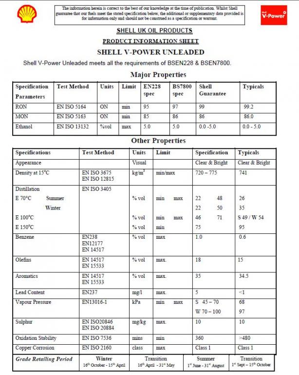

trials1951 Posted December 22, 2013 Report Share Posted December 22, 2013 The best up to date information I have from old colleagues at Shell research is that Esso Premium is Ethanol free. Shell V-Power Nitro contains 5% Ethanol Quote Link to comment Share on other sites More sharing options...
woody Posted December 22, 2013 Report Share Posted December 22, 2013 I've used Shell V-power (optimax before that) for years and have had no issues with fibreglass or rubber being eaten away. I don't drain the tanks, the fuel is left in. Quote Link to comment Share on other sites More sharing options...
stickinthemud Posted January 15, 2014 Report Share Posted January 15, 2014 Looks like you've been lucky so far Woody. I emailed both Shell and Murco back in 2011 as I'd heard that their fuels were ethanol free. This is the spec sheet they sent me for Shell V-Power with the following reply. VPower and Fuelsave Unleaded are blended with 5v% max ethanol. See atttached datasheets for your reference Regards, Chanda Technical Helpdesk It may that some refineries do not add ethanol yet as the Murco's reply pointed out As a company Murco do not have Ethanol in any of their products at this moment in time, however some of our garages are supplied from non-Murco terminals so in this case the Ethanol content would be 5%. I hope this is of some use to you. Regards Chris Blake When I rang Murco to follow this up they couldn't tell me which garages were ethanol free except that it was the ones in the Midlands. Many riders are now adding a drop of 2 stroke oil to 4 stroke fuel to put a film of oil on the carb slide etc. Ethanol has also ruined the tank on my 1999 Triumph Tiger 855. It became covered in blisters after the dampness in the garage last winter. The best precaution is to empty the tank when not in use and take care with the jet wash round the carb and filler cap! Good luck Quote Link to comment Share on other sites More sharing options...

yamanx Posted January 23, 2014 Report Share Posted January 23, 2014 Best way is to seal the tank against ethanol laced fuel, apparently some BP stations in the south still sell ethanol free petrol, but its rare and going to get worse as they introduce even more bio into our petrol. Even the additives break down after a while, I've never come across anything that works that well. I store my bikes dry if possible. Ethanol in fuel can even start gumming up the carb in just a few weeks, and can be a git to clean out of the very small jets. But to stop it attacking the tank, use POR15 to seal the tank. Best way is use thinners and some old nuts to wash it out, be careful with thinners if you have a plastic tank, shake it until your arms are dropping off, then do it again. Coat it with POR15 then leave to dry, as the sealer dries it can sometime run down into the tank, so I use a computer fan on the tank to dry it out quickly, keeping more of an even coat inside. Quote Link to comment Share on other sites More sharing options...
