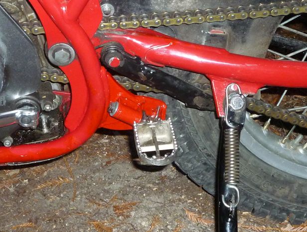

seldredg Posted January 8, 2014 Report Share Posted January 8, 2014 I also have NJB Experts, 15.3 inches, and I raised the forks in the triple clamps by about 3/4 inch. The bike now turns. I can make tight turns nearly as well as on my Gas Gas. I had the foot pegs relocated down and back by building another bracket off the end of the existing one, and I used Hebo foot pegs. This makes a large difference in how the bike feels. I feel less perched way up on top of it. I'm getting measurements of how much the rake and trail changed with these changes. I'll post pictures later if I can. Quote Link to comment Share on other sites More sharing options...

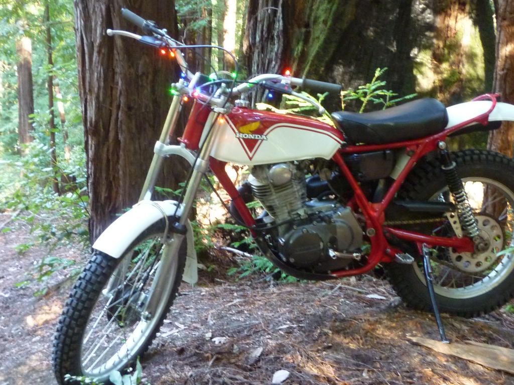

seldredg Posted January 11, 2014 Report Share Posted January 11, 2014 Bike with 15.3 inch shocks and footpegs back and down. Quote Link to comment Share on other sites More sharing options...
htrdoug Posted January 11, 2014 Report Share Posted January 11, 2014 I've ridden a TL250 with the rake pulled in to make it turn. Felt great to me. By keeping the stock length shocks you keep the center of gravity low and the swingarm angle flatter which I think makes the suspension action feel better,keeps the chain from pulling the bike down into it's travel under power.....But the increased ground clearance may be worth the trade off on TL's,I never road the deraked TL in any sections that would give me a real feel for how it would do in competition....I would absolutely lower the footpegs though,seldreg's mod looks spiffy ;-) Just some alternative thoughts Quote Link to comment Share on other sites More sharing options...

seldredg Posted January 11, 2014 Report Share Posted January 11, 2014 I've ridden a TL250 with the rake pulled in to make it turn. Felt great to me. By keeping the stock length shocks you keep the center of gravity low and the swingarm angle flatter which I think makes the suspension action feel better,keeps the chain from pulling the bike down into it's travel under power.....But the increased ground clearance may be worth the trade off on TL's,I never road the deraked TL in any sections that would give me a real feel for how it would do in competition....I would absolutely lower the footpegs though,seldreg's mod looks spiffy ;-) Just some alternative thoughts Using the long shocks does raise the CG, but I like the steering improvement. I'm tall and have a high CG. The stock bike already felt high and top heavy and ill proportioned with the foot pegs, so the raising the CG a little more couldn't make it much worse. I'm getting a new frame, and will go back to a stock length on the shocks. Do you have any idea how much the rake was pulled in? I've read factory riders did 1.5 degrees, but I don't what the stock rake is. Quote Link to comment Share on other sites More sharing options...
