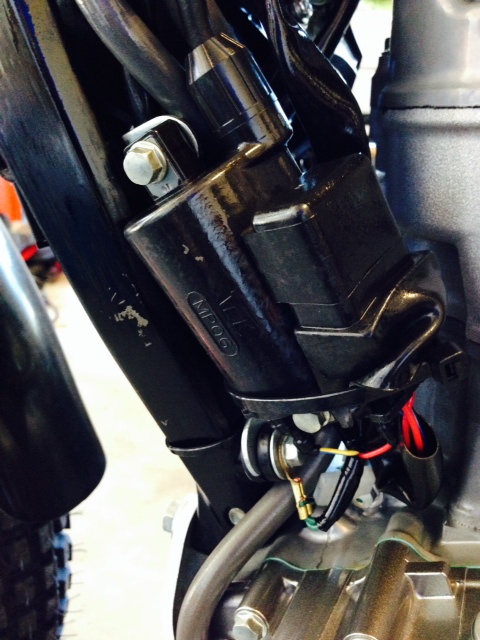

billyt Posted January 2, 2014 Report Share Posted January 2, 2014 Hey Guys What is the black box that is piggy backed to the HT Coil on my 2014 Repsol? See picture below. Thanks Quote Link to comment Share on other sites More sharing options...

shedracer Posted January 2, 2014 Report Share Posted January 2, 2014 My guess, someone has moved the fan relay! Quote Link to comment Share on other sites More sharing options...

maxbikes Posted January 2, 2014 Report Share Posted January 2, 2014 I agree fan relay,2 red wires going to it are positive. Quote Link to comment Share on other sites More sharing options...
jj65 Posted January 2, 2014 Report Share Posted January 2, 2014 (edited) Also agree, fan relay, can't think why it's been put there, normally lives in front of the fuel tank, next to the oil catch tank on my 2012, it's factory mounting point is next to the tilt switch under the tb. Edited January 2, 2014 by jj65 Quote Link to comment Share on other sites More sharing options...

billyt Posted January 2, 2014 Author Report Share Posted January 2, 2014 Thanks guys. So the consensus seems to be a the fan relay. No scratches as yet, the marks you see are from shipping tape residue. Thanks Quote Link to comment Share on other sites More sharing options...

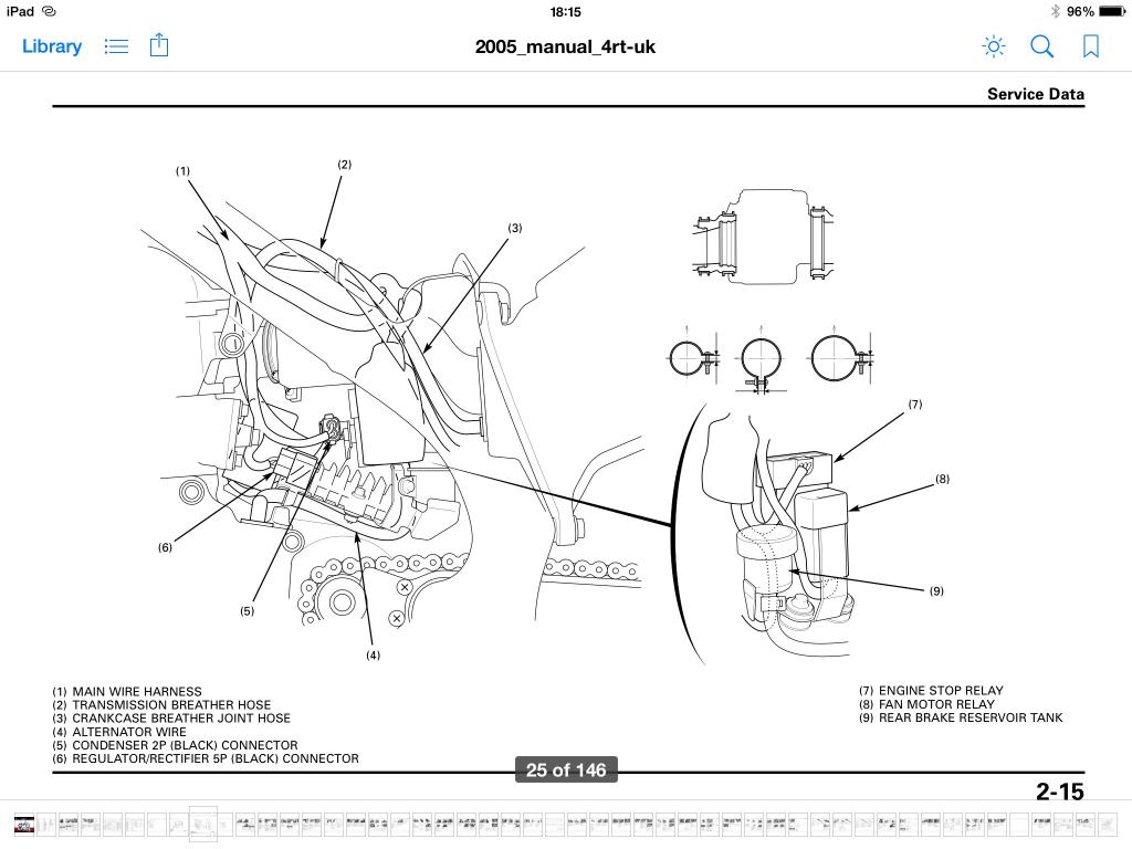

jj65 Posted January 2, 2014 Report Share Posted January 2, 2014 (edited) This shows where the fan relay sits under the throttle body next to the rear break reservoir. If you have this then the question would still stand. If it is the fan relay, I'd move it either back to the original position, or preferably either in front of the fuel tank or rest it on top of the throttle body connector. Edited January 2, 2014 by jj65 1 Quote Link to comment Share on other sites More sharing options...

munch Posted January 2, 2014 Report Share Posted January 2, 2014 it clearly is the fan relay . 2 x red a blue and blu /blk wire . shocking pdi ! but have seen worse from the previous 'official' importer! . as jj 65 has illustrated it slides onto a bracket in front of the airbox, it is a little tricky! as there is only just enough wiring . it squeezes between the head and frame ( just the plug ,relay removed ) and then down in front of the brake resevoir . but that is where it sits. if you go for a simplified breather system it slots on to the breather catch tank bracket . it's importtant that it is relocated ,as in later life it will from experience give issues. Quote Link to comment Share on other sites More sharing options...
