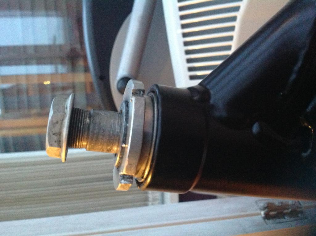

leeporter Posted January 4, 2014 Report Share Posted January 4, 2014 Hi I'm having a nightmare with this scorpa nothing has been easy.i have started putting the yokes back on only to find the steering is not smooth is this the bearings? Also which way round does the castellated nut go is it small lip to the top or to the bottom many many thanks in advance Lee Quote Link to comment Share on other sites More sharing options...
canada280i Posted January 4, 2014 Report Share Posted January 4, 2014 Looking at the pic I would say small lip to te top so that the hex nut locks down on it Quote Link to comment Share on other sites More sharing options...
lineaway Posted January 4, 2014 Report Share Posted January 4, 2014 If you look at the bearing race, it is quite noticeable if the bearing is the problem. Quote Link to comment Share on other sites More sharing options...
leeporter Posted January 4, 2014 Author Report Share Posted January 4, 2014 How would I check what would I be looking for Quote Link to comment Share on other sites More sharing options...
lineaway Posted January 5, 2014 Report Share Posted January 5, 2014 Usually you will find the races look marked. They will have slight dimples from the bearings. Quote Link to comment Share on other sites More sharing options...
