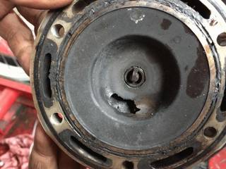

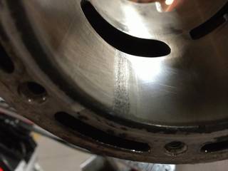

jse Posted January 13, 2014 Report Share Posted January 13, 2014 I agree, if the new owner has shown total disregard and blatantly abused the bike then yes, tough titties, however, does the previous owner know that for sure, as by his posting there seems to have been some kind of misunderstanding some way along the line. " He sent me some pics of the cylinder head which has what looks like a melted hole in it, another pic of the piston which seems to have a piece of metal stuck to it and another pic of the cylinder inside which has a big gouge in it (I think from the metal that is stuck on the piston)." I don't think I can remember knowing a rider who would continue to ride a Trials bike, with the obvious symptoms of distress the engine undoubtedly exhibited, to the point of this type of damage. I think there is more to the guys story than he is telling you..... Jon Quote Link to comment Share on other sites More sharing options...

phil0925 Posted January 14, 2014 Author Report Share Posted January 14, 2014 If you have a weak heart and love your Gas Gas then don't open the attachments! Quote Link to comment Share on other sites More sharing options...
canada280i Posted January 14, 2014 Report Share Posted January 14, 2014 mmmmmmm...strawberry milkshake, my favorite! I take it the piece of metal on the piston is the piece from the hole in the head? Quote Link to comment Share on other sites More sharing options...
blocky Posted January 14, 2014 Report Share Posted January 14, 2014 In my humble opinion, This was the order of failure... Hot spot developed on the cylinder (Look at the heat mark on the right of the crack in the head) This in turn led to one or more parts of the head cracking away into the cylinder. This in turn punched the hole larger forcing shrapnel into the water jacket and probably into the exhaust too. When the shrapnel worked its way into the water pump this jammed the impeller causing the stripped thread. So what caused the hot spot ? You mentioned earlier I think that the engine had recently been de-coked I think. Mostly likely damaged at that point. May have been too small to see with a naked eye. Quote Link to comment Share on other sites More sharing options...
jse Posted January 14, 2014 Report Share Posted January 14, 2014 That's a new one for me. I can understand the impellor stripping, actually fairly rare from my experience as usually caused by the rider taking the brass plug out of the pump to drain the fluid and the thrust washer falling off the shaft end and into the housing and binding the impellor to the housing (it also allows the shaft end to sit into the housing too far and the impellor scrapes the inside of the pump housing, and I don't see signs of that here). Obviously it's hard to see details in the photos, but I don't see any obvious signs of detonation but the rings seem to be seized in the lands (could have happened due to excessive heat, and "after the fact" of the main cause). The hole in the combustion chamber is unique, however, and may have been a surface fracture that let loose and a possible cause of previous overheating issues-chamber gases pushing into the cooling system. I think that's the first one of those I've seen. You could not have normally predicted a material failure of this sort unless you carefully inspected the chamber for cracks while the engine was torn down (not a normal proceedure in my experience other than in high-end racing applications). It does look like the engine was stopped (locked up) when the chamber wall came apart (and the piece got stuck in the squish area) but it also seems that this engine was run beyond the time it should have been shut off when the first overheating symptoms were noticed. First rough guess is material failure in the head chamber. Jon Quote Link to comment Share on other sites More sharing options...
