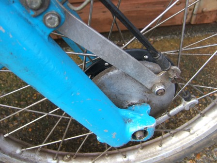

Anyway one of the bikes is a white framed, Bultaco 340, it has what appears to be normal Bulto forks but on one side has no pinch bolts, Is this correct or is it a replacement fork leg that has not had holes drilled or the slot cut??

Some of the later fork legs were like that from the factory (mine is the same).

If its late 3000 or even 4000 it may be one of the last and from your descriptions it is. It may have an alloy head steady, and the forks came like this on the subsequent italjets so its a kind of upgrade!

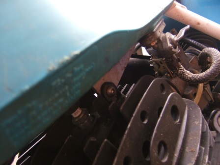

many thanks for those ultra quick early responses. i will get some photos and post them. on the 340, yes it has an alloy head steady, it has the 340 engine fitted, Bing carb etc, somebody appears to have cut and welded about an inch into the exhaust pipe above the cylinder head, neat job and nicely done, but why??. The "spare motor" is the 250 198B, i will obtain numbers and scratch the paint off and post frame numbers as well. The 340 has seen some hard use, but what a beautifully smooth motor, even with the Bing which i had been led to believe were not the best.

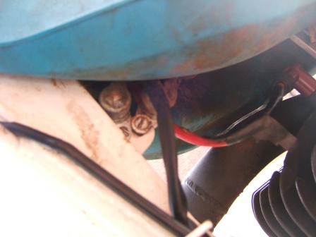

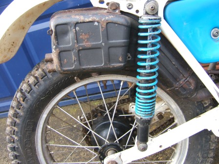

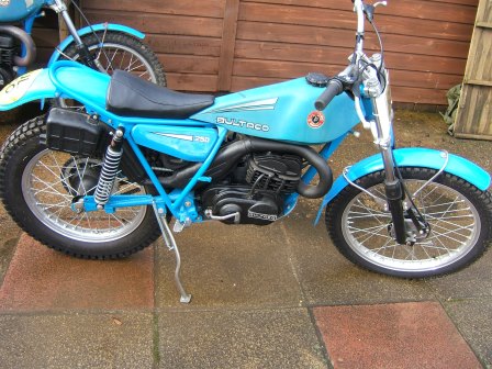

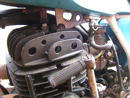

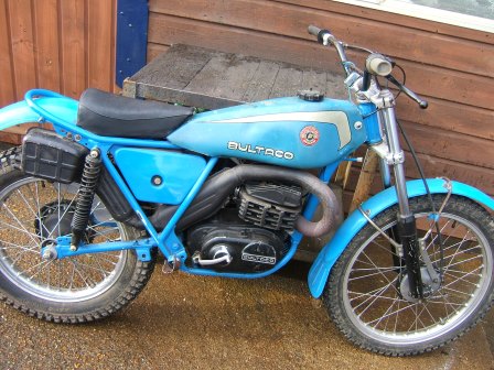

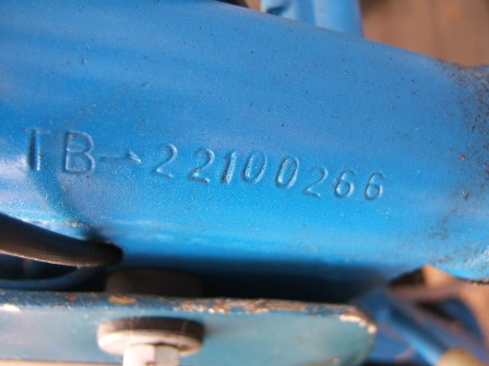

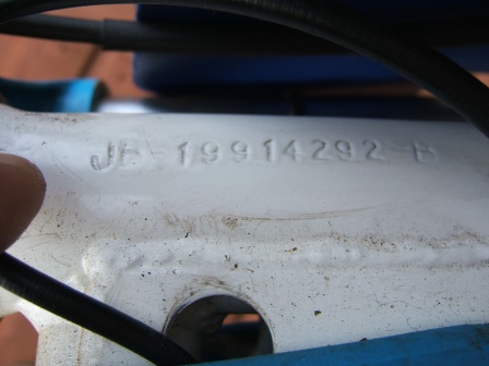

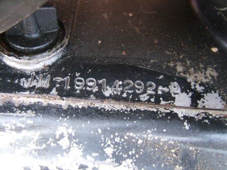

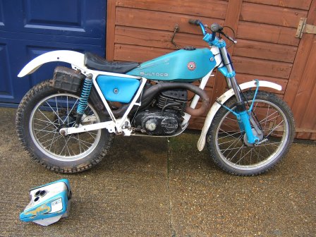

Well here they are, all 3 of them.
1 off nicely restored 198A, 1 off nice little 175 sherpa, with a 50" wheel base, is that correct or has someone ridden into a wall, needs restoring, but a beautifully quiet little motor??
Probably the best of all for me is the 199B, matching Engine and Frame no. JB199 14292-B. she is a bit scruffy but rides beautifully, this bike was apparently on ebay a few months back, it has 2 condensors fitted, an 1" added in the front pipe, an alloy air box, although the one fitted is clearly wrong being from a 1976 ish bike i believe. if anyone recognises it or has any info please let me know
i will probably leave the 198A as she is, the 199B will need a sympathetic restore, i would like to find an alternative tank, i don't like plastic and have heard the decals won't stay on, will a 198 style alloy tank fit?? what shockers would be considered an upgrade, new betors?, i don't want to spend a fortune as my riding ability is not worthy of it? Also although the bike is running ok, i think a few quid spent on the carb would be worth it, or possibly a new carb, AMAL, MIKUNI or OKO????
The one giving me the most trouble on a decision is the 175, were they any good? it is a short wheel base and seems to have a higher ride height. or I suppose I could turn it into a 250 and find a different frame, any ideas or suggestions
The 175 is nice, even to ride, it's not very powerfull compared to the 350 and 250 but works and will do any job that has to be done during a classic trials.
I personal would replace the tank against the plastic model. I too believe in quite good technical order you will have most fun with 175cc Bultaco.
Edited by pschrauber
The 175 used a 250 frame, it's basically a 250 bike sleeved down to 175. Easy to convert back to 250 with an overbore. Yes the wheelbase is correct because the 250 frames between '76 and '78 differed from the 325. They had a bend in the front tube just under the headstock and had shorter forks. They handle well and turn a bit quicker than the 325. From '78, they went back to using the same frame for the 250 as the 325.
199b - If you use an alloy tank from the model 198 you will also need the corresponding seat. That shape tank had a different slope at the rear from the plastic tank, so the front of the seat has to match. But they won't look right on the 340 at all. They only came with the plastic tank or a one-off UK alloy tank which was a squarer, different shape which is not the same shape as the plastic tank (or therefore, the alloy tank that is currently made in Spain) Shedworks do a fibreglass ethanol proof tank the same shape as the plastic tank but about 1" slimmer. Either in blue gelcoat finish or plain for painting, both options allow the use of decals (you're right, decals won't stick to the plastic tank)
The exhaust looks standard. The weld you've pictured is normal.
The 199b airbox is unique to the b model and works fine. The 199 and 199a used a different airbox which was considered restrictive and the factory riders used to replace it with the older type. Someone seems to have done the same to your bike for some reason.
If ultimate performance isn't needed, a pair of steel bodied Betor shocks should do the job as they work reasonably well and are a reasonable price.
If the bike runs fine I wouldn't waste money on a new carb, especially if you're not using it in serious competition. If you do want to fit one, a 28mm OKO (not the powerjet version) works well. I have one on my 340 and it only needed a slight decrease on the pilot jet to a 39 from stock settings. They're about £60 off ebay. I only mentioned not a powerjet version as mine is the normal carb, so I don't have jetting for a powerjet as they are different I think.
I was told by a 175 owner (from New and still owns it) that the crank was different to the 250, so not as easy a swap ?
I couldn't say specifically that it wasn't, but I'd be surprised as the 175cc model 221 is just a renumbered 250cc model 190 with the capacity reduced to 175cc by sleeving down the bore size. The stroke is still 60mm.
Originally produced for the rental market as in some countries rental bikes were restricted to 175cc. Difficult to see Bultaco producing a one-off crank when they could just resleeve the cylinder, given their financial problems as well at that time.

On closer inspection the 340 bike requires a little more than light restoration! it has one or two other interesting features such as a Titanium bash plate and Titanium snail cam adjusters!! the photos don't show it but there has definitely been an inch added in two places in the front pipe, once about 3" from the exhaust port and then again straight above this where the pipe passes under the fuel tank, I have 4 other 79 front pipes here and none have these welds.
Thank you for the info on the 175 geometry, was there a reason why they made the bike 2" shorter for the 76-78 Sherpa 250 and then back to the full 52" for later models. with modern sections becoming tighter and tighter perhaps a short wheelbase bike would be useful?

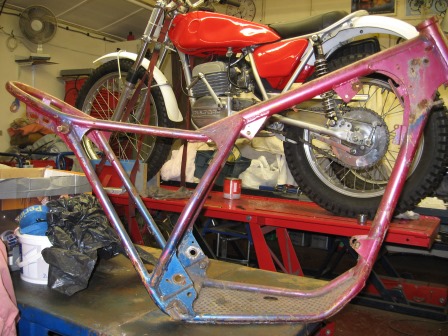

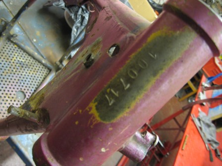

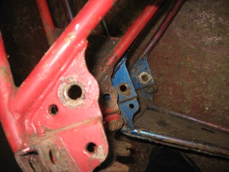

Along with the bikes I picked up a spare frame I will post photos, it does not have the usual Bultaco frame number it is just digits, 100**** from what I can remember also the frame has no swan neck but when laid on top of a standard 79 it is again shorter like the 175 frame with the s/arm pivot being approx 2 " further forward. I find it all quite interesting, especially when most people say 'oh yeah all Bultacos are the same!"
I was told years ago that one of the mods done by Reg May was to add 1" sections to the exhaust near the cylinder and then above to add 2" length increase to the main pipe. Not sure if this mod was worth it but if Reg May did it I suspect others would also give it a try.

Hi All,
more photos of the odd Bulto frame i have acquired, as always any help guidance very much appreciated.
Bultaco used the no 100 to start thier prototype / development bikes serial nos followed by 3 other nos , never seen or heard of one as high as 717 though and i was under the impression this stopped around 1973/4 , think one of motocross rider jim pomeroys frames was stamped in to the high 200s and that was around 72 ish,they only made a few bikes each year stamped 100 xxx
