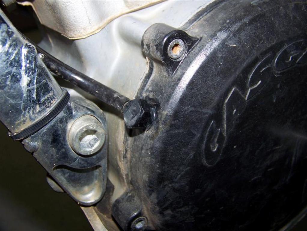

jse Posted January 31, 2014 Report Share Posted January 31, 2014 (edited) On 1/31/2014 at 7:11 PM, shipdamite said: amazes me that there isnt a breather on the pro.............. lots of condensation from here. at both ends of the spectrum, my ktm 300 exc and ty 175 both have breathers. I might make one for the pro - easy enough to do. I add a breather to all my Trials bikes, since the early Bultaco days. Never had a water ingestion problem. Jon Edited February 2, 2014 by jse 1 Quote Link to comment Share on other sites More sharing options...
mr neutron Posted February 2, 2014 Report Share Posted February 2, 2014 (edited) I used to use an old Mikuni main jet for my ignition cover vents. Drill the correct size hole, tap the metric threads, put a dab of sealer in in the threads part of the hole, screw in the main jet, and slide a hose over it. I also used to drill a small hole for water to drain out, as well, somewhere on what appeared to be the very bottom of the cover, I figured if water could get in, I'd give it a way out........ There's defintely simpler/cheaper fixes out there. Jon, what do you use for that fitting? Is it something with a hose barb on it? Back on topic, is it possible at all that the oil he's seeing could be chain oil that got flung up in there somehow? As in maybe there's not a good seal between the cover & the case? Jimmie Edited February 2, 2014 by mr neutron Quote Link to comment Share on other sites More sharing options...
canada280i Posted February 2, 2014 Report Share Posted February 2, 2014 I just installed one on my ossa using one of these: http://www.smarthome.com/31018/Orbit-67400-DripMaster-1-4-Barb-Elbow-Bag-of-20/p.aspx Drill hole in cover, push barb fitting in, epoxy in place, attached a piece of hose up under the tank cover, seems to work okay, sealed the cover to keep moisture out 1 Quote Link to comment Share on other sites More sharing options...
