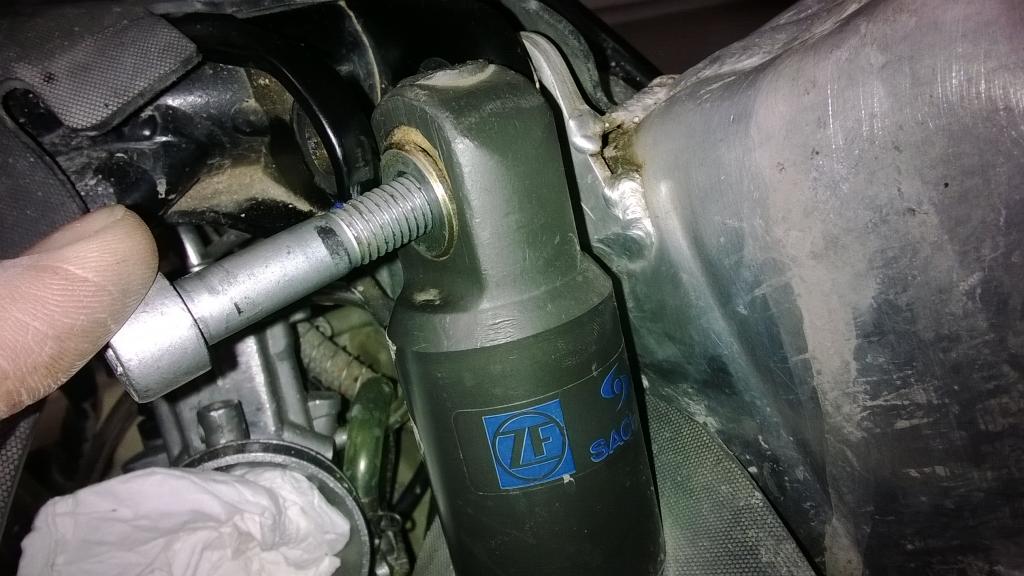

kurt Posted February 1, 2014 Report Share Posted February 1, 2014 There is some play on the top mount of the rear shock on my GasGas 300 2007. I notice this when lifting the bike at the rear end.See the photo, the top bushing or is it a silent bloc? Is this replaceable? How does stock these parts? Easy to do, or do I need a hydraulic press? Quote Link to comment Share on other sites More sharing options...
kurt Posted May 4, 2015 Author Report Share Posted May 4, 2015 I'm still looking for a solution, to get a rear shock without play. Anyone an idea? Quote Link to comment Share on other sites More sharing options...
steve_earle Posted May 4, 2015 Report Share Posted May 4, 2015 You will need to change the bearing, It will look like this one, But you will need to find the exact one for your shock from a bearing shop or Gas Gas. They push in and out of the shock body. http://www.splatshop.co.uk/rear-shock-rose-joint-kit-1999-to-2005-ge12.html Quote Link to comment Share on other sites More sharing options...
