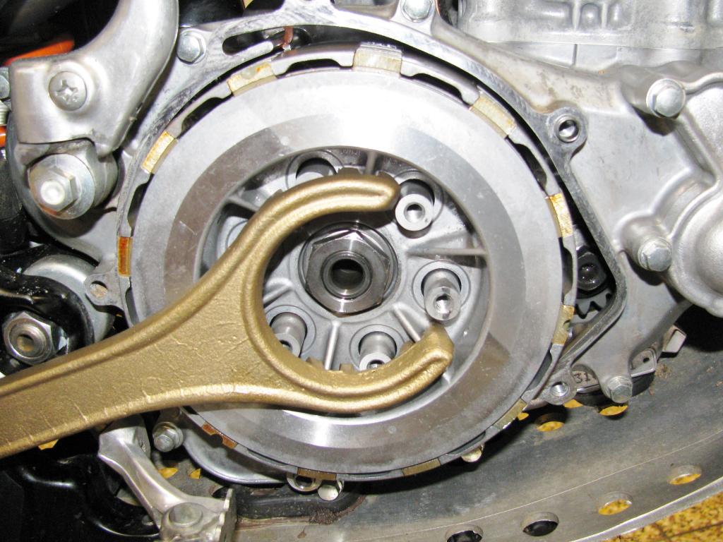

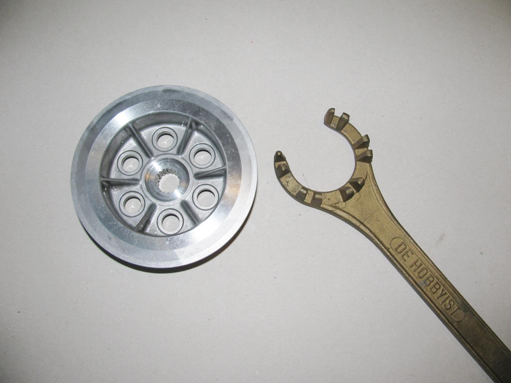

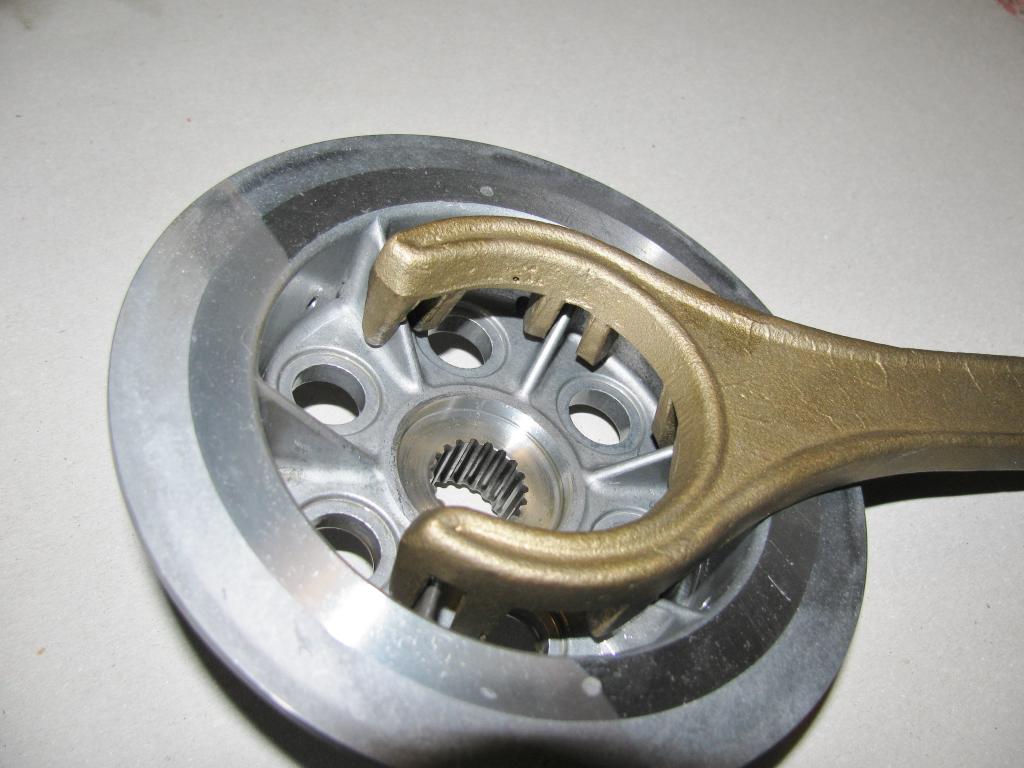

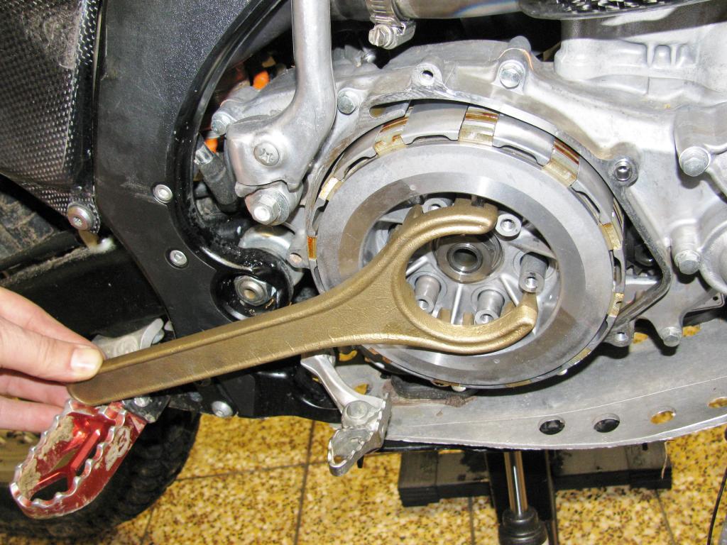

I planned to put an Mitani clutch in my Monty but noticed while disassembling, I needed a tool to hold the clutch basket in order to remove the (very tight) central nut.
Luckely I have such good taste to not only ride a 4RT but also a 1988 BMW R100S. :-D
The spanner to loosen the exhaust star nuts on my Beemer was perfect for the job
