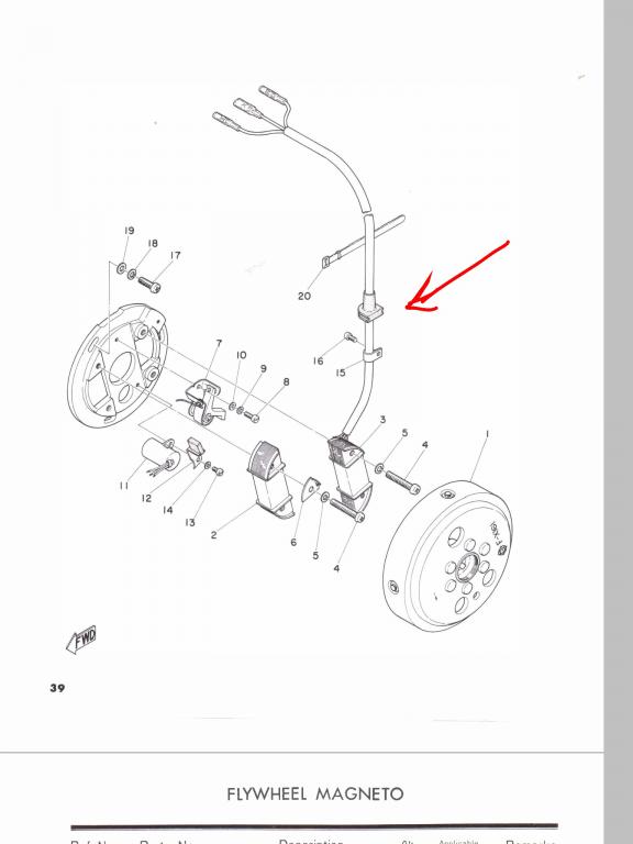

motosolex Posted March 11, 2014 Report Share Posted March 11, 2014 Hi. In need of the rubber holder which protects the Lighting Coil wires where they exit the engine case. This part has no part number but I found a supplier that will manufacture the part provided I send him some pictures of the part. Please post some pictures of the part to be made by: www.claussstudios.com Thank you kindly Quote Link to comment Share on other sites More sharing options...

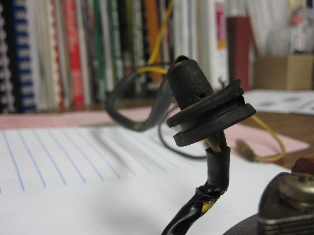

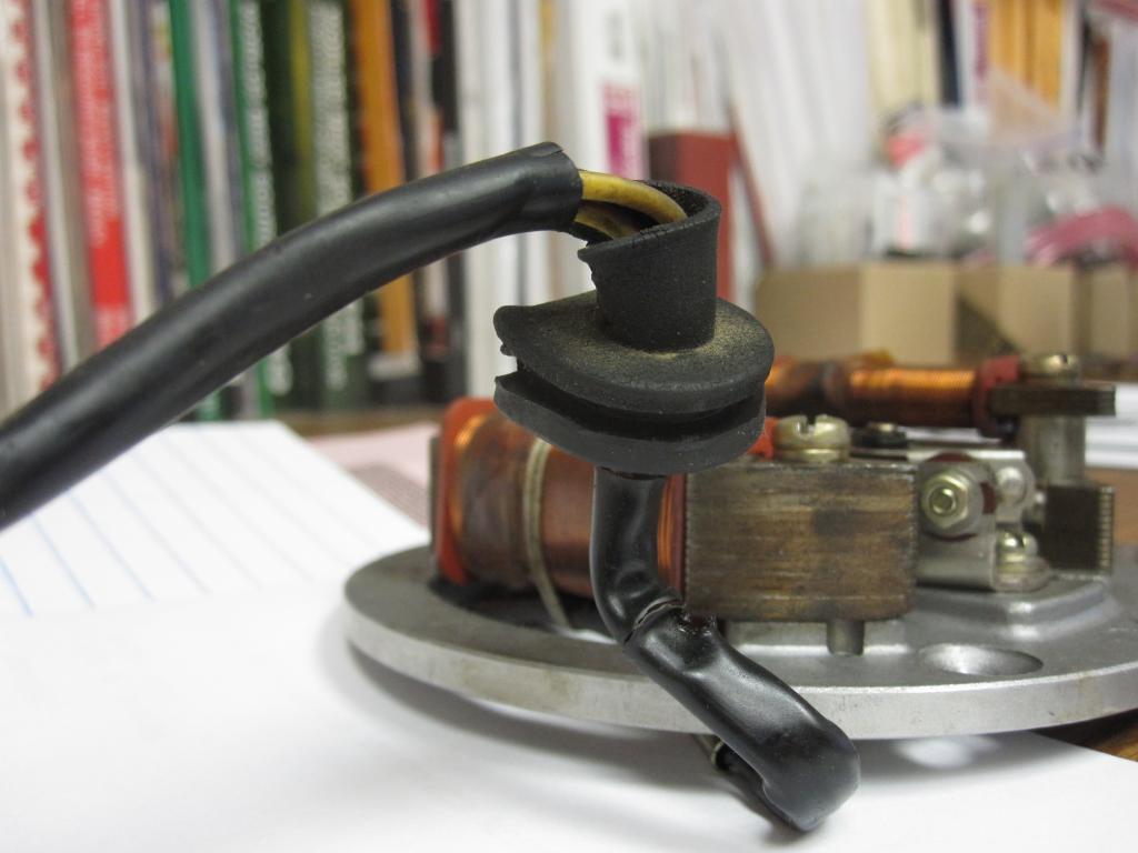

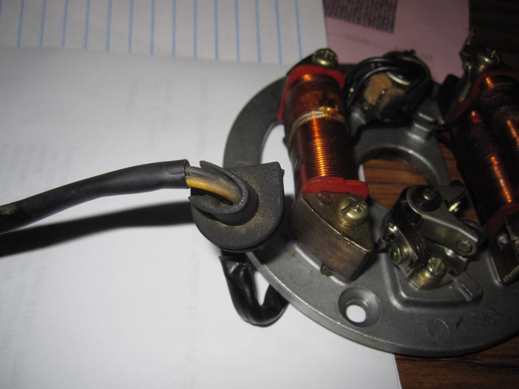

mike1952 Posted March 12, 2014 Report Share Posted March 12, 2014 I too am interested in the rubber grommet. I have attached some pictures The grommet is 21mm across the flat back. It is 13 mm from the flat back to the crown on the front. The channel around the grommet that fits on the side cover is 3mm deep. If you are having some made, I would be interested in purchasing 10 of the grommets. Let me know Mike Quote Link to comment Share on other sites More sharing options...
