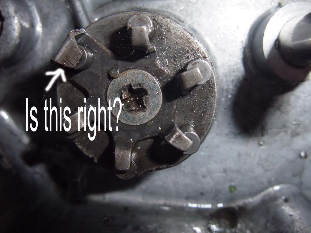

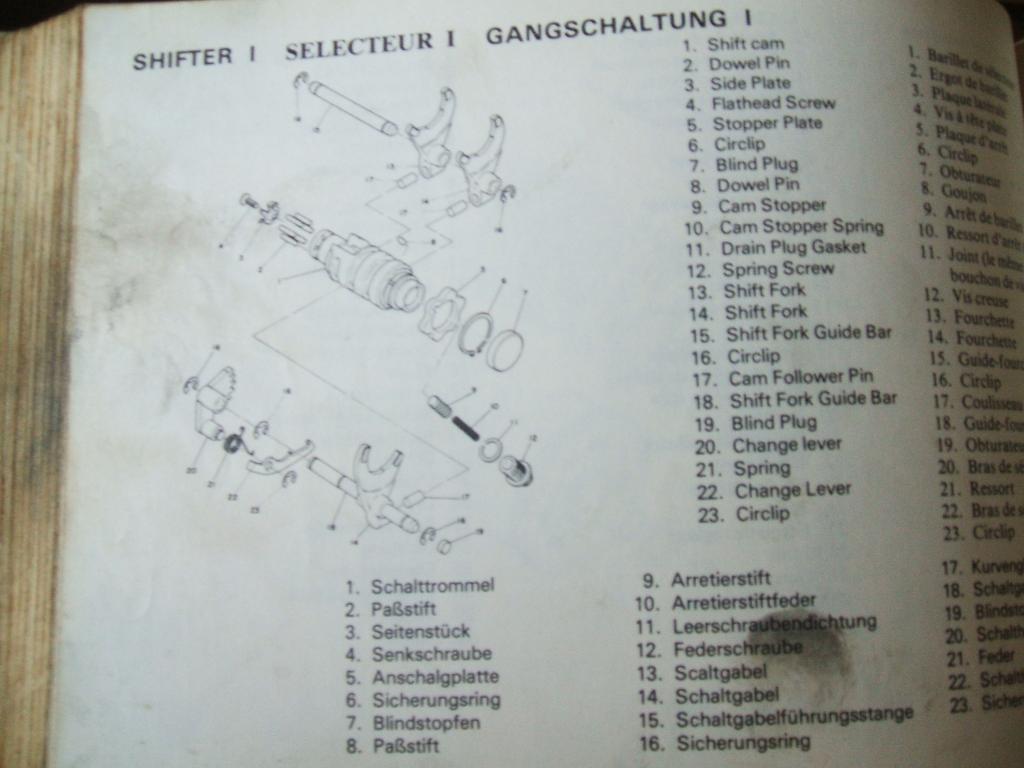

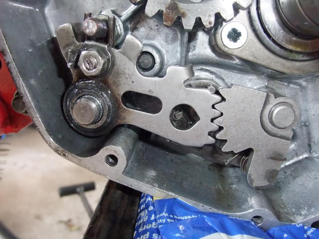

festerbestertester Posted March 30, 2014 Report Share Posted March 30, 2014 I am struggling with gear selection and wonder if the "spidery washer on the cam assembly is in the correct position. Also is there a setting for the selector arms? (second pic) Ignore lack of circlips as just put on for pic. Quote Link to comment Share on other sites More sharing options...

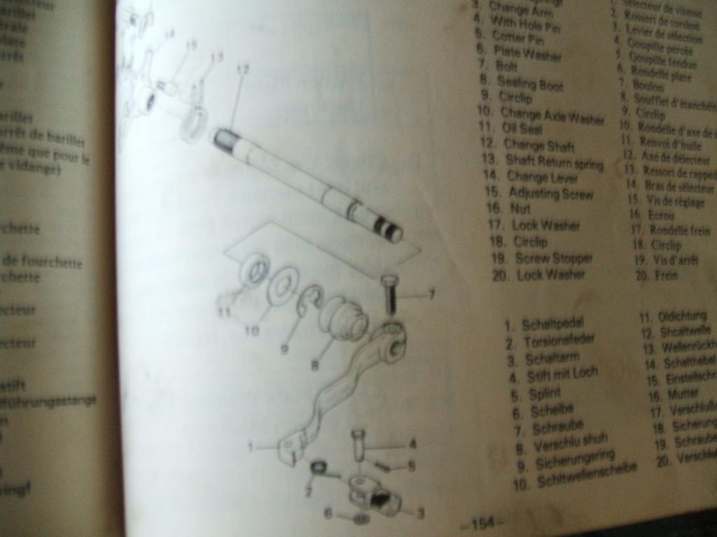

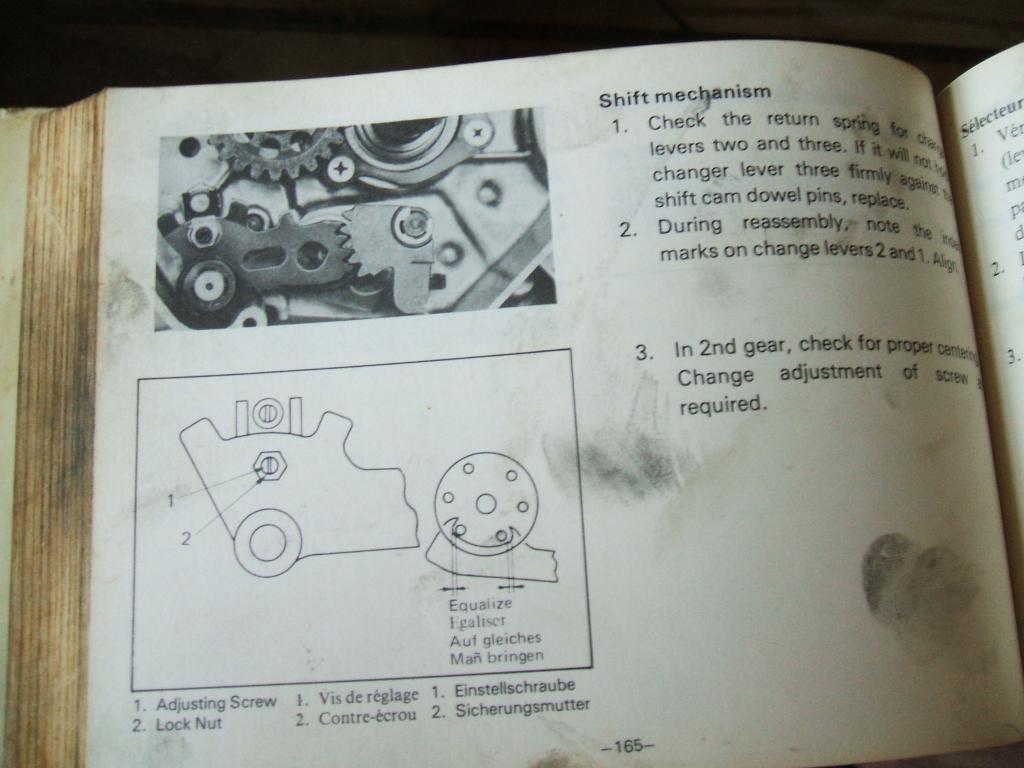

airman Posted March 30, 2014 Report Share Posted March 30, 2014 These pictures might help. Quote Link to comment Share on other sites More sharing options...
festerbestertester Posted March 30, 2014 Author Report Share Posted March 30, 2014 The arrowed part on pic 1 seems to catch Quote Link to comment Share on other sites More sharing options...
airman Posted March 30, 2014 Report Share Posted March 30, 2014 The shift shaft return spring does not look like it returns to center, try adjusting the screw with lock nut to center the teeth when shifter returns to center position. Quote Link to comment Share on other sites More sharing options...
festerbestertester Posted March 30, 2014 Author Report Share Posted March 30, 2014 Will give it a try in the morning Quote Link to comment Share on other sites More sharing options...
festerbestertester Posted March 31, 2014 Author Report Share Posted March 31, 2014 Whoopee!!! I have gears. Many thanks Airman, wish I had a Manual! Quote Link to comment Share on other sites More sharing options...
