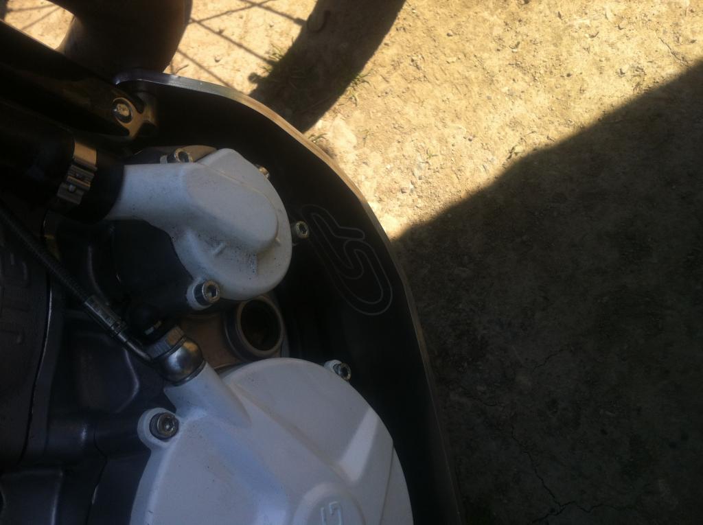

telecat Posted April 20, 2014 Author Report Share Posted April 20, 2014 (edited) Damage was "limited" to the Lugs being knocked off the case. Delay down to the Clutch mech under the case being different so the new case needed the New Mechanism. I gather it's aluminum rather than Steel. Inner case was just a little bent and was straightened. New Bash Plate already showing it's mettle. The Costa Special Part is thicker and Pennine have used longer rear bolts with Ny-lok nuts to hold it on. Chris was having a good ride at the Spen Valley Trial At Tong when he the bike fell on his knee at Section 10. Still hobbling today. Edited April 20, 2014 by telecat Quote Link to comment Share on other sites More sharing options...
telecat Posted April 20, 2014 Author Report Share Posted April 20, 2014 (edited) As Promised New Bash Plate. And in Action before hurting his knee. Edited April 20, 2014 by telecat 2 Quote Link to comment Share on other sites More sharing options...
