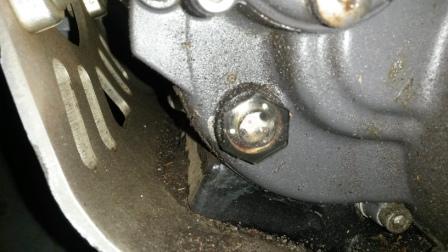

Never said it was easy. The primary flywheel is pretty close to the sight glass and I don't see it. Obviously to be certain you can drop the side cover.
