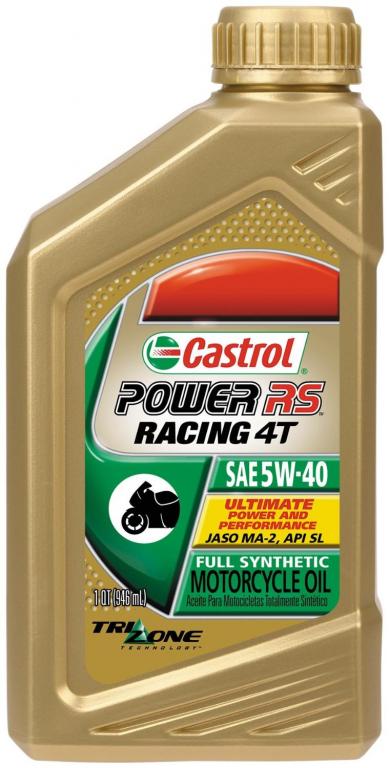

billyt Posted April 9, 2014 Report Share Posted April 9, 2014 (edited) A grabby clutch is more down to clutch materials than oils. However one does not have to much of a choice when it comes to clutch materials on stock trials bikes. With that being said One is forced to experiment with oils. I swear by this oil and currently use it as my 2014 Montesa Repsol clutch oil. I agree with Dad02 stay away from ATF.............. Check out Castrol Tri Zone on You Tube on how this oil works well on clutches. BillyT Edited April 10, 2014 by billyt Quote Link to comment Share on other sites More sharing options...
0007 Posted April 10, 2014 Report Share Posted April 10, 2014 Ya I agree, I have tried a few and it seems like many are good but some seem to have some property that increases drag regardless of viscosity Weird thing Quote Link to comment Share on other sites More sharing options...
