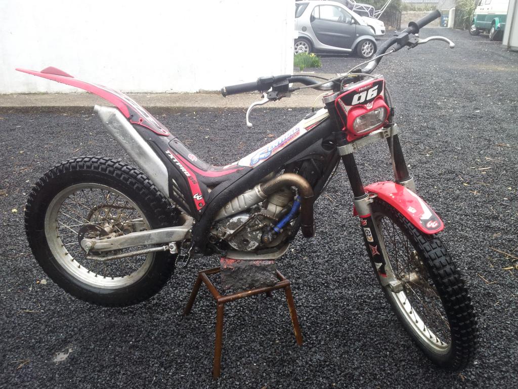

renegade master Posted April 30, 2014 Report Share Posted April 30, 2014 Hi all, My mates txt pro 300 year 2006 wont start, we have checked it for spark and no spark, we suspected it to be the cdi unit,so off he went and bought one brand spanking new cdi unit !!!..........., we pluged it into the bike today but still no spark??? has anybody came accross this with there bikes before and if so could kindly shed some light on the subject!!! Cheers Guys Colin. Quote Link to comment Share on other sites More sharing options...

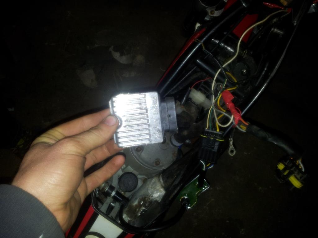

renegade master Posted April 30, 2014 Author Report Share Posted April 30, 2014 Thanks guys, Just before we take off the flywheel can I just ask something quick! When trying to test for spark by holding the plug off the side of the engine to see if it sparks,when we kick start the head light comes on for a split seconed, does this mean that theres power comming up from the flyweel??? and does that mean we do no need to test or take off the flywheel? or check the stator? Quote Link to comment Share on other sites More sharing options...
renegade master Posted April 30, 2014 Author Report Share Posted April 30, 2014 could this be the problem? and is there an eazy way of testing this? also whats the trigger coil, and source coils? Cheers guys Regards, Colin Quote Link to comment Share on other sites More sharing options...
sectionone Posted May 1, 2014 Report Share Posted May 1, 2014 Your Ducati regulator/recitifier box handles power for the spark plug, fan and lights. I've had three of them fail on me, once no spark, twice no fan. Each time there was a brown burn spot on the epoxy on the back where a circuit burned out. If your headlight turns on I bet your stator is working. 1 Quote Link to comment Share on other sites More sharing options...
renegade master Posted May 1, 2014 Author Report Share Posted May 1, 2014 Thanks for that, ............earlyer I had a look on youtube how to test the recitifer with a multimeter, and the test results I got when I tried this was that the readings were very unstable and were different all the time, its kinda leading me to believe thats it the recitifer now after reading your above comment setionone! Himmm the joys of owning a gas gas! Cheers guys Colin. Quote Link to comment Share on other sites More sharing options...
