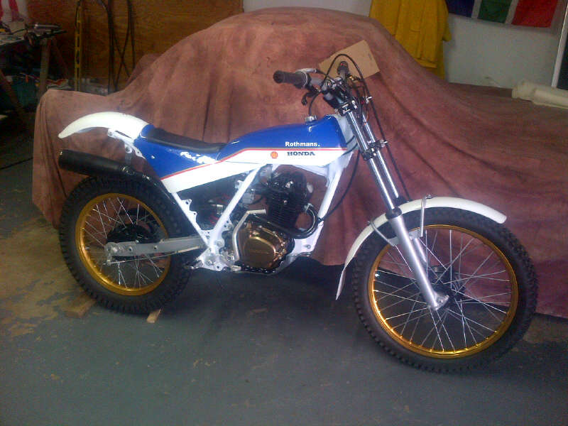

Try find a old twin shocker and convert it into a classic trials bike. My dad has recently built 3 bikes. Donar bikes were Xl and Xr200 (rothmans).
They would be good enough to get you started.
