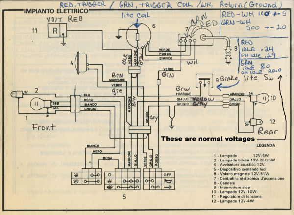

fasteddy Posted May 13, 2014 Author Report Share Posted May 13, 2014 Thanks, Sourced the fork guards, and have the clutch working, need a wiring diagram badly, Thanks again.. Ed.. Quote Link to comment Share on other sites More sharing options...
axulsuv Posted May 13, 2014 Report Share Posted May 13, 2014 (edited) This schematic is for a Section , but it should get you in the ballpark ... Have fun ! Glenn Edited May 13, 2014 by axulsuv Quote Link to comment Share on other sites More sharing options...
fasteddy Posted May 13, 2014 Author Report Share Posted May 13, 2014 Thanks Glenn, Seems I'm missing a voltage regulator, I'm trying to find power for the rad fan, I know there is power as I got a shock from the bolt on the lighting switch. Some of the stock wiring is missing for sure. Ed. Quote Link to comment Share on other sites More sharing options...

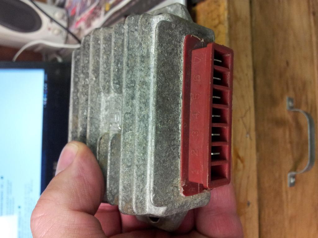

fasteddy Posted May 14, 2014 Author Report Share Posted May 14, 2014 I've found the rectifier/regulator for the bike, no wires are connected to it and I have no idea what connector is the input, there are 6 connections, numbered 2 to 7, #1 has no connector, I do not want to try trial and error for fear of damaging the unit, would anyone have any insight on this. Thanks Ed.. Quote Link to comment Share on other sites More sharing options...
axulsuv Posted May 15, 2014 Report Share Posted May 15, 2014 (edited) Contact http://www.fanticmotor.asso.fr/ they may have the diagram you need , I think mine is different ? Glenn Added on edit , The first schematic is the wrong one , let me hunt down the correct one here somewhere inside this machine .... Edited May 15, 2014 by axulsuv Quote Link to comment Share on other sites More sharing options...
