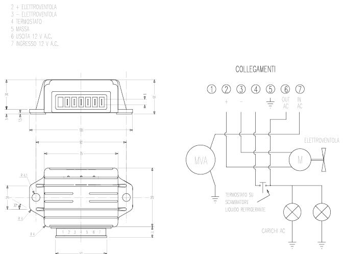

fasteddy Posted May 15, 2014 Report Share Posted May 15, 2014 I was able to contact the Italian manufacturer of the Regulator (http://www.idm-srl.it/motorcycles.asp) They sent me a schematic of the regulator, thought I would share with all in case someone else can use the info. Ed.. 1 Quote Link to comment Share on other sites More sharing options...
