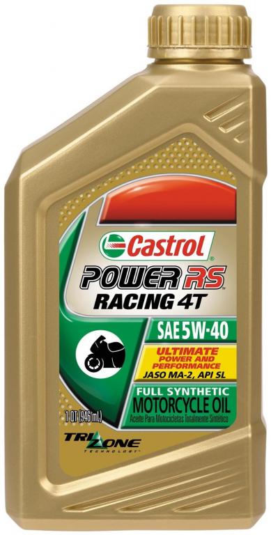

billyt Posted August 14, 2014 Report Share Posted August 14, 2014 (edited) I use the 5/40 in the clutch and 10/40 in the gear box. The lighter weight oil works great in the clutch and the heaver oil for the gear box. Even though this oil is a synthetic it does not cause clutch slippage. The Trizone technology is the secret. Trizone as in Gear Box, Wet Clutch, Engine. I would suggest you educate your self on “Trizone” on Castrol’s web site. Edited August 15, 2014 by billyt Quote Link to comment Share on other sites More sharing options...

ross brown Posted August 15, 2014 Report Share Posted August 15, 2014 (edited) I use the 5/40 in the clutch and 10/40 in the gear box. The lighter weight oil works great in the clutch and the heaver oil for the gear box. Sorry i thought we were talking 4RTs here. The Elf oil replacement under discussion goes into a single chamber that houses both the clutch AND gearbox/ transmission. The other oil, the one in the 10w-30 or 5w-40 range is for the engine oil that circulates in the forward chamber .and lubricates crank, cam chain, valves and so on. Edited August 15, 2014 by ross brown 1 Quote Link to comment Share on other sites More sharing options...
guys Posted August 15, 2014 Report Share Posted August 15, 2014 (edited) Sorry i thought we were talking 4RTs here. The Elf oil replacement under discussion goes into a single chamber that houses both the clutch AND gearbox/ transmission. The other oil, the one in the 10w-30 or 5w-40 range is for the engine oil that circulates in the forward chamber .and lubricates crank, cam chain, valves and so on. You're right about the places where the oils go, but according to my manual it's 10W40 for the engine oil. Edited August 15, 2014 by guys Quote Link to comment Share on other sites More sharing options...
