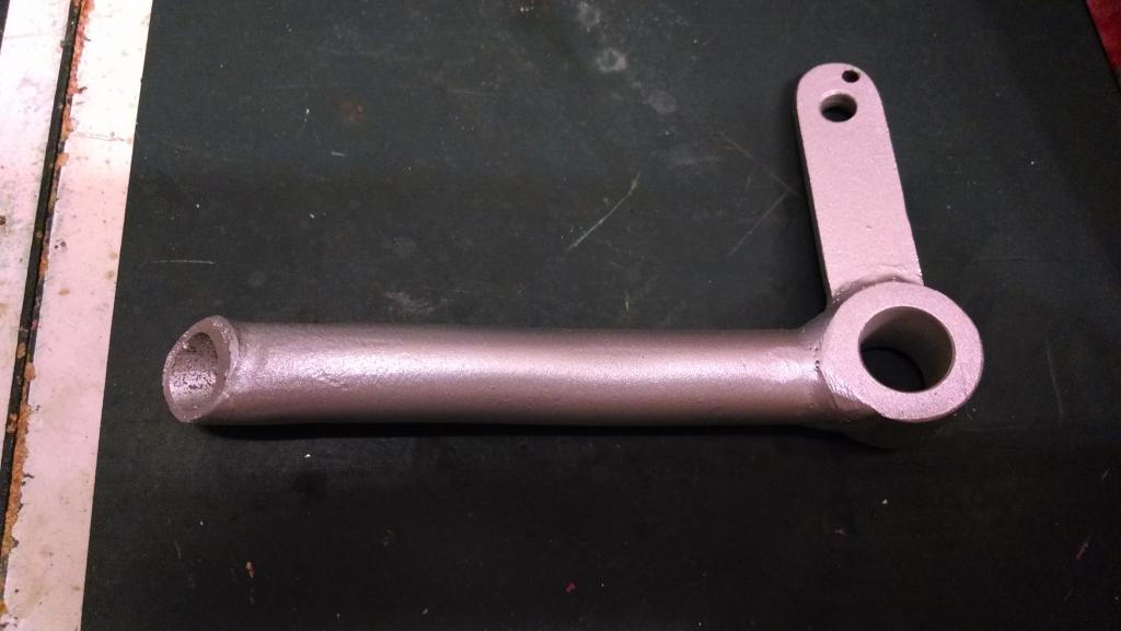

rlk_76 Posted May 15, 2014 Report Share Posted May 15, 2014 Would anyone know of a fix for this brake pedal? Seems the previous owner chopped it up. Should I weld something on or look for a replacement? Not many websites carry this type. Thanks. Quote Link to comment Share on other sites More sharing options...
bestrcpilot Posted May 15, 2014 Report Share Posted May 15, 2014 I would just weld a new piece on it. It looks like it was cut, broken at the weld joint. Not sure but looks like a Sammy Miller petal to me. Quote Link to comment Share on other sites More sharing options...

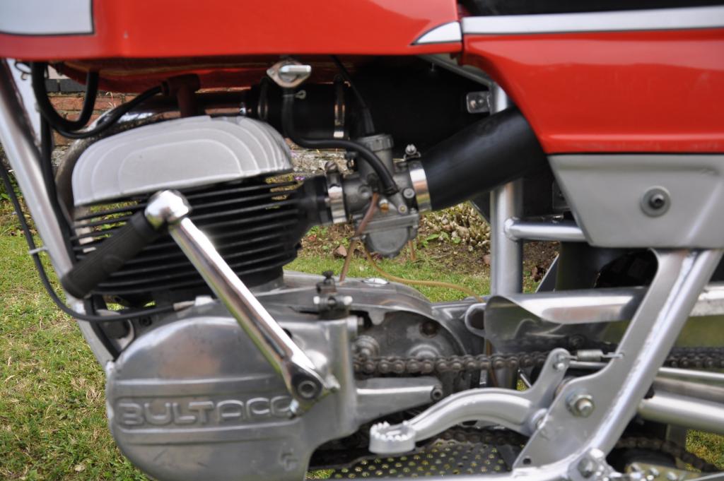

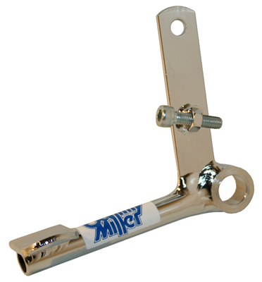

p@ul250 Posted May 16, 2014 Report Share Posted May 16, 2014 This is the one that Sammy Miller Products sell. and this is what a standard Bultaco one should look like. I would suggest that you weld a piece of steel on the end of yours for your toe and keep an eye on the on-line auction sites for a standard one. (they do pop up from time to time). Quote Link to comment Share on other sites More sharing options...

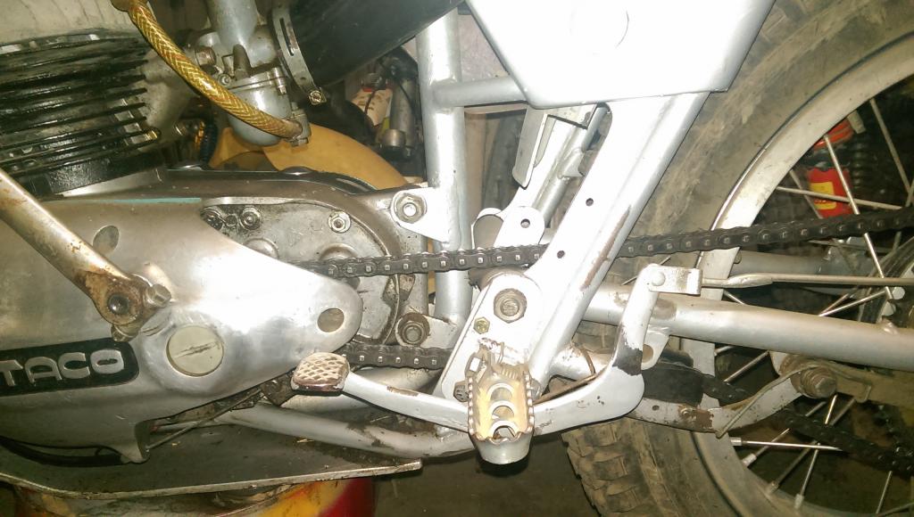

feetupfun Posted May 16, 2014 Report Share Posted May 16, 2014 For info, this is also a M49 brake pedal, but from an earlier M49 than the ones with the pivot located inside the frame 1 Quote Link to comment Share on other sites More sharing options...
