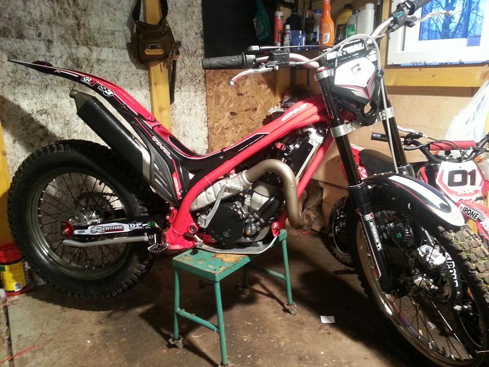

lockie28 Posted May 18, 2014 Report Share Posted May 18, 2014 hi guys hope yous can help on a couple of Q's .............. I'v recently bought my first gasgas txt pro 2010 after being a sherco man for some time. The rear silencer seems to stick out slightly to the side of the bike is there any way this can be straightened to sit in a perfect line? Also CLUTCH drag . . . I have changed the mineral fluid in the mastercylender but can't seem for the love of god to elimenate drag , 3mm play at the lever ect ect iv done the lot . . . any other tips or problems the gassers are prone to with the clutch that could be causing this? I know they all drag but this is exessive! Any help will be gratefull , cheers again Ian. Quote Link to comment Share on other sites More sharing options...
lockie28 Posted May 18, 2014 Author Report Share Posted May 18, 2014 also .... when i pull the clutch in ( bike not running ) quickly a few times i can hear a slight purging sound coming from the clutch casing? is this normal? clutch sleve cylinder?? Quote Link to comment Share on other sites More sharing options...
lineaway Posted May 18, 2014 Report Share Posted May 18, 2014 You need to measure the clutch pack for proper thickness. Go to gas gas motos and download a manual. http://www.gasgas.com/Pages/Technical/Pro/clutch-measurements.html Quote Link to comment Share on other sites More sharing options...
smarty156 Posted May 18, 2014 Report Share Posted May 18, 2014 If you push the silencer towards the wheel to get it more in line you'll be in danger of the tyre wearing through it. Quote Link to comment Share on other sites More sharing options...
mic Posted June 4, 2014 Report Share Posted June 4, 2014 When i bought my bike it had a real bad clutch drag and i tested different oils and checked the clutch pack size etc, (there are a good thread about it here on the forum) all was up to spec, next i ordered a repairkit for the mastercylinder replaced it and refilled the system from the bottom up getting rid of all air and it works perfect. Quote Link to comment Share on other sites More sharing options...
