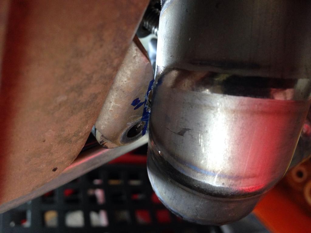

I just bought a second hand S3 pipe of ebay for my Rev3 its in as new condition with a light coat of fresh oil (not carbon) inside the bloke who I bought it off said it had only been on for while which I did wonder why, I might have found out it dosent fit properly.
With the pipe pushed in the mid box the front of the pipe hit the bolt that fixes the radiator, with that out of the way the radiator bracket, the gap was about 8mm more to make up with gaskets so I shaved off a bit of the radiator bracket lug and the pipe hits the strut that links the frame and bash plate, its about a 3mm gap between the 2 mating faces so with 2 gaskets and some sealant I should be good.
If I would of bought this brand new I could of took it back and it can be got over any way but has anybody else suffered this fate with there pipe or have I got unlucky again.

The pipe could be bent. I have also seen several bikes where the midbox gets twisted/shifted from light to heavy crashes and makes refitting a pipe (even the same one that just came off) difficult to fit back on. The midbox typically gets torqued pretty good when the rear silencer gets hit.
Seems like youve already tried to make midbox adjustments, but maybe worth another look. If you haven't done so already, make sure all the midbox mounts are loose before trying to the align pipe. good luck.

I don't think the pipes been bent out of shape as literally looks brand new just seems its not been manufactured to the right measurements it's not bottoming in the mid pipe as much as it hit the radiator fixing lug and now strut(s)

The Akropovic I had on my 08 was right up against the bolt. In fact you could see where the bolt was scratching it's way into the titanium. And yes it was brandy new. These hand built pipes are a little variable.
