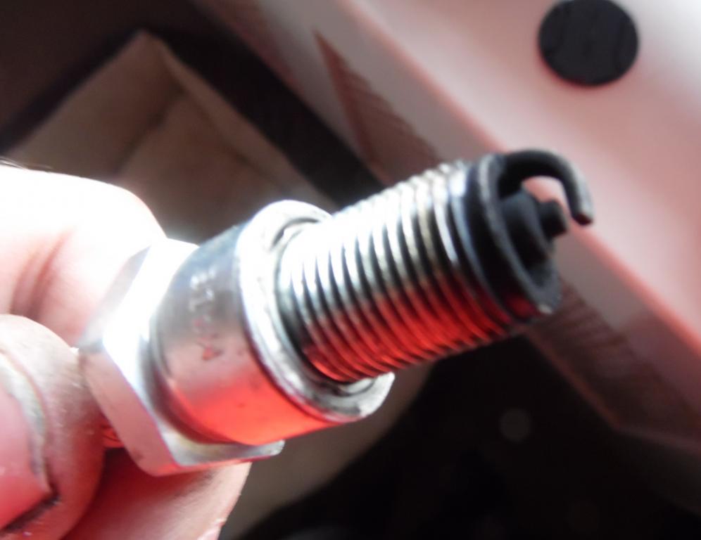

toetoe Posted June 2, 2014 Report Share Posted June 2, 2014 i cleaned my bike today and as always after i have finished i start the bike and run it for a few minuets but today it ran for about a minuet and then started to pop and just cut out, i thought i could of got water in to some where with using a pressure hose but i have done the same thing every week and it has always been ok, after cleaning the carb, filter and air box i let the sun dry it out for a while but still no luck i then took the plug out and swapped it for an old one i had and it started on the first kick so i need to know a few things about spark plugs, first the plug i had in is about 3 months old so is that about the life of a plug in a trials bike, my bike is about 14 years old and here comes the silly question, can i kill a plug by water getting in from some where or was today just one of those coincidences, i took a photo of the plug almost as soon as it came out but it was wet with petrol and not dry like it is in the photo. Quote Link to comment Share on other sites More sharing options...
dadof2 Posted June 2, 2014 Report Share Posted June 2, 2014 The plug in the photo is carbon fouled. Do you leave your cold start enrichment on for some time? If not the carburation is a bit rich. Quote Link to comment Share on other sites More sharing options...

dadof2 Posted June 3, 2014 Report Share Posted June 3, 2014 Cold start enrichment, this is the device that lets a rich mixture get around the throttle slide to enable cold starting. It is not a choke (although some people mistakenly call it a choke) The fouling on your plug is dry, ie it is excess petrol. If it were excess oil the dark parts would look shiny not matt. 10 seconds of cold start enrichment should not do this. Check your air filter is clean, then check the float height. Then give the bike a good hot run with a new plug. Only after that start to change the jetting if the plug is still dark. You can't rule out a failing HT coil, source coil, poor connection or other fault in ignition circuit. Try disconnecting kill switch first. 1 Quote Link to comment Share on other sites More sharing options...
thats_a_five Posted June 6, 2014 Report Share Posted June 6, 2014 So many people confuse gas/oil mixture with being "rich." Being rich is the condition of having too much fuel in the air mixture. This can be caused by many things: incorrect jets, needle position or improper air/fuel screw setting, dirty air filter, plugged exhaust, etc. Adding more oil to the fuel actually makes the fuel/air mixture more lean. Dadof2 is correct in saying this plug is fuel fouled, not oil fouled. That plug can be reused after a good cleaning. When riding 2 strokes, I clean the plug before every event. I also carry a spare plug and a small wrench on the bike in case it fouls. That doesn't happen often but a fast plug change can get you back riding and finishing the event. Quote Link to comment Share on other sites More sharing options...
