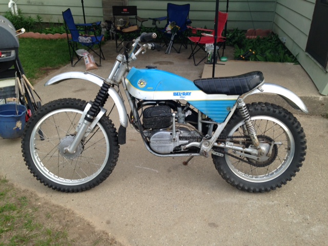

kevs84s Posted June 9, 2014 Author Report Share Posted June 9, 2014 thanks. the plug could have a little more color in my opinion but is turning brown, i only have a hour or so riding time on it with full synthetic oil i had on hand mixed 40:1 with no ethonal premium. carb is set at one turn and runs best there, i have not checked needle position at this point. it starts right up hot or cold. here is a pic with lights and speedo removed for refurb. Quote Link to comment Share on other sites More sharing options...
lineaway Posted June 9, 2014 Report Share Posted June 9, 2014 Nice looking bike, not meant to be reved too hard. Basically a trials motor with a big tank. If you keep that in mind it is a great trail machine. Have fun. Quote Link to comment Share on other sites More sharing options...
