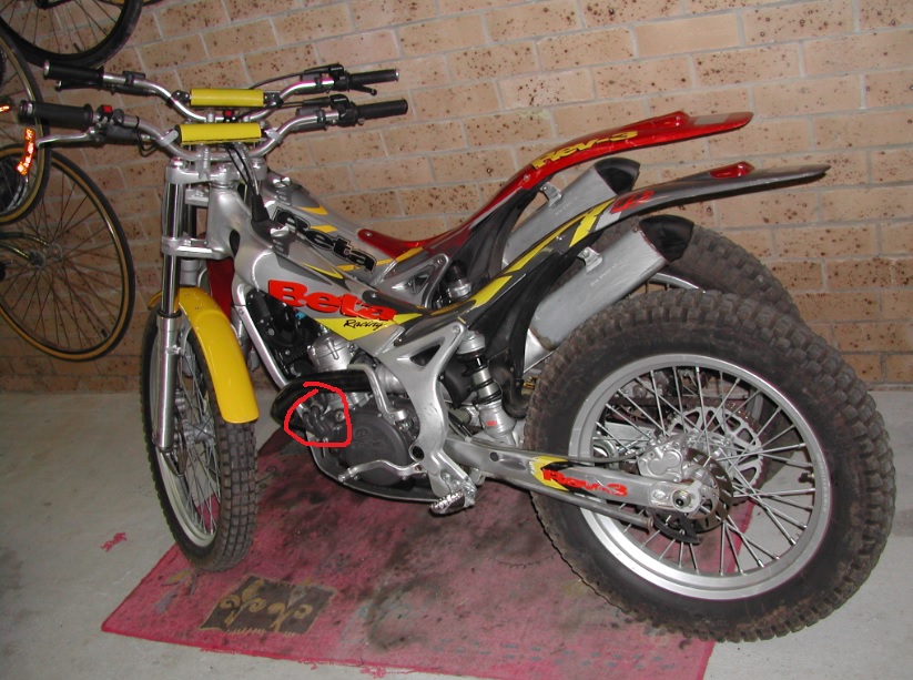

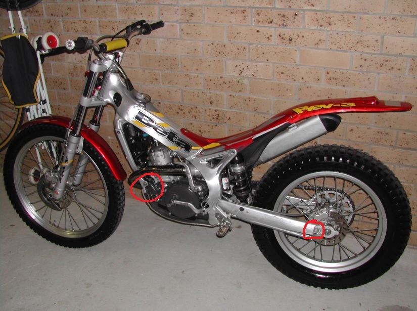

eviljim Posted June 15, 2014 Author Report Share Posted June 15, 2014 Thanks, can I confirm then that the 2002 does not have the magnesium casing then. I seem to recall reading it came in later but can't find that post again. Quote Link to comment Share on other sites More sharing options...
worldtrialchamp Posted June 27, 2014 Report Share Posted June 27, 2014 correct, it is aluminium.....can see by the waterpump cover casting. 2003 onwards has a twin cavity casting which indicates magnesium clutch cover (although 125, 200cc may still have had aluminium, I'd have to check part numbers) something to check for on the 2002...the rear brake caliper torque lug...they are poorly welded into the swingarm and can snap off..seen quite a few do this....2003 on had better welding Quote Link to comment Share on other sites More sharing options...
