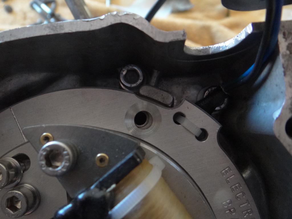

mmmexico Posted June 19, 2014 Report Share Posted June 19, 2014 My TY 175 is progressing nicely. I have read on this forum the mixed results that people have had with the Electrix World system. Some have said some very nice things, others have had no luck and everyone seems to agree that they are not especially communicative with their customers. In my case, I sent several e-mails and none received any response at all. When I ordered an "electronic ignition" from an American source, the Electrix World unit arrived. So...that's what I am using. The unit appears to be very well made, but as you can see from the photograph, the unit just doesn't quite match up, so I'm going to have to be doing some grinding with my Dremel tool on the engine case. No big deal, but why couldn't they have done a better job?? I have a couple of questions about the unit itself. First of all, how is the spark triggered? With a points system, it is obviously clear. With the CDI systems that I am familiar with, there is some sort of a mechanical, electromechanical trigger associated with some part of the motor, usually the flywheel. With this unit, there is no obvious trigger. How does it work? Secondly, how much success have you guys had adjusting the timing of this unit? The instructions simply say that the unit will provide a good spark as delivered in the box, and any further adjustment will require a timing light and the creation of timing marks on the magneto flywheel. Have you found that necessary? Hope to hear from you guys about your adventures with this unit Mike meditativemachinery Quote Link to comment Share on other sites More sharing options...
dadof2 Posted June 19, 2014 Report Share Posted June 19, 2014 (edited) I would email your photo to the supplier and ask them if they think the stator plate they have supplied is faulty before cutting metal from your engine case. Get their permission to cut away their part instead. If there is no sign of a timing trigger the system almost certainly uses the change of polarity at maximum voltage to signal the CDI. This type of system gives similar / same timing to points. Edited June 19, 2014 by dadof2 Quote Link to comment Share on other sites More sharing options...

feetupfun Posted June 19, 2014 Report Share Posted June 19, 2014 I helped fit an Electrex ignition to a friend's Ty175 about 3 years ago and did not come across that problem you are illustrating. Maybe the kit you were sent is for a different bike. I know that the Ty175 and Ty250 backing plates are similar but different so it could be that Quote Link to comment Share on other sites More sharing options...
slickgolf_0 Posted June 20, 2014 Report Share Posted June 20, 2014 I just received one of the same units , its exactly the same , wont line up . I called them just now but no one technical to speak to , they say they will ring me back > Lets see ! Its an easy fix however its a new part , I should not be having to machine anything . Quote Link to comment Share on other sites More sharing options...

canada280i Posted June 20, 2014 Report Share Posted June 20, 2014 In the interest of getting the bike running, why not just file a little off the plate itself rather than modding the case. It looks like it would only take a little filing to get it in place. I know it is supposed to fit but the alternative is to wait for a replacement that may end up having the same issue anyway 1 Quote Link to comment Share on other sites More sharing options...
feetupfun Posted June 20, 2014 Report Share Posted June 20, 2014 In the interest of getting the bike running, why not just file a little off the plate itself rather than modding the case. It looks like it would only take a little filing to get it in place. I know it is supposed to fit but the alternative is to wait for a replacement that may end up having the same issue anywayMaybe it is because we both live so far from the UK, but this is my take on the problem too. I find that there are lots of times that aftermarket parts I buy need a few tweaks to fit properly, not just ignitions Quote Link to comment Share on other sites More sharing options...
tony27 Posted June 21, 2014 Report Share Posted June 21, 2014 The ignition on my 250 needed no modification to fit, the grommet for the cases wasn't perfect but wasn't a issue due to me sealing it up with silicone as a standard practice to ensure water can't get in Do the other mounting screw holes line up? If they do then you may have to slot the hole otherwise it shouldn't take much to rotate the plate enough with a small amount of modification to the plate Quote Link to comment Share on other sites More sharing options...
