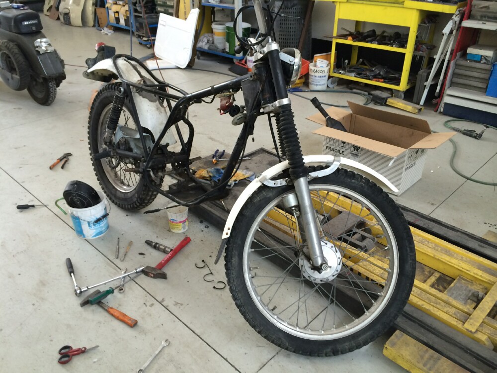

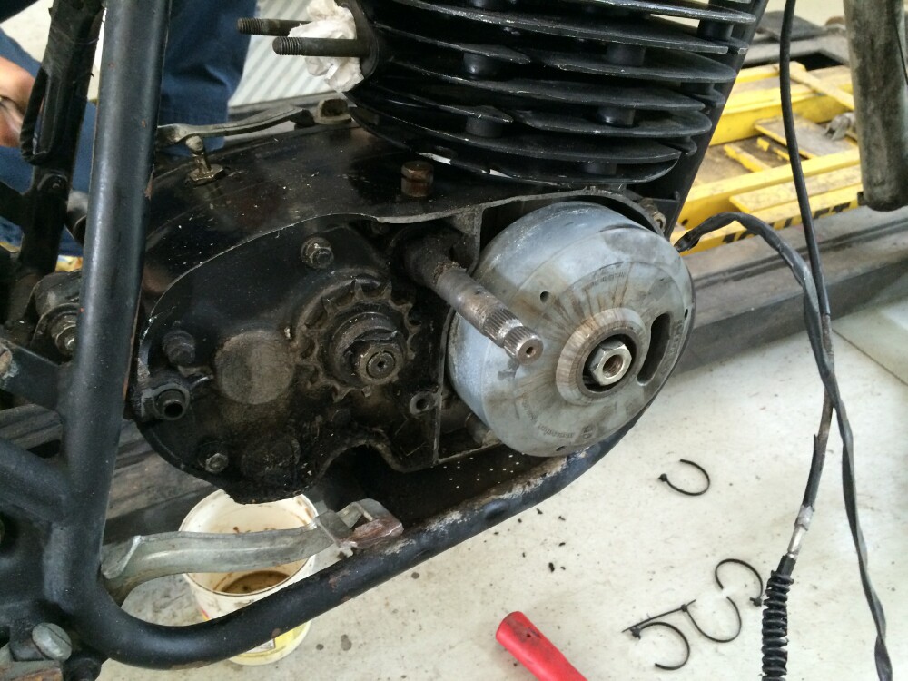

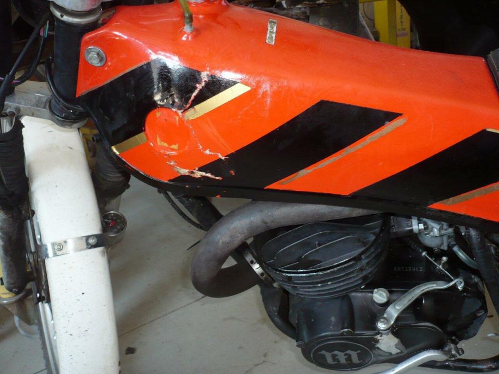

Thanks for your answers. I hope that these pictures are a bit better, sadly the bike has been taken apart by now so an overall pic is not possible.... But your help/ideas will be very much welcum. Thank you!

Cio Stefano
It looks like you have a very late Montesa Cota 247 built somewhere around September/October 1980.
The last 247's had the 348 style tank as Feetup said, possibly with the large tandem seat like the Trail version that also had rear folding footrests on the swinging arm. The Trail version also had lights fitted as standard.
As for the engine casings originally being black, certainly the later bottom half covers were black as they again followed the trend set by the 348/349, but some Ulf Karlson replica versions had the shiny alloy covers with the same M relief pattern and some were black! I would check Google Images on Cota247 for sales brochures that look similar to your bike for confirmation.

Hello and thank you for your answers, all of them very helpful for a Montesa 'old newbie' like myself. Dave, your Mk4b is beautiful!
Regarding the black engine,TopCat very correctly observed that it could be a 248 bottom case and 247 top end, but I am editing my answer as I found (call me slow, but I noticed it only this afternoon, as the bike is 30 miles away from my home and checking is not easy....) that the engine and chassis numbers match, so the engine and chassis were born together and put together at the time of the first assembly of the bike. It is also clear that this is a true 247, as its chassis/engine numbers are 21M2**** while the Montesa: VIVA book by mr Herreros show that the 248 had numbers beginning fron 21M51***.
It would be useful to know if anyone has a Montesa chassis numbers list so to check when this unusual late-series 247 was produced. Sorry for the editing, but I thought that it was not correct to keep here some wrong remarks that I made before I found the reality of the matching-numbers chassis.
