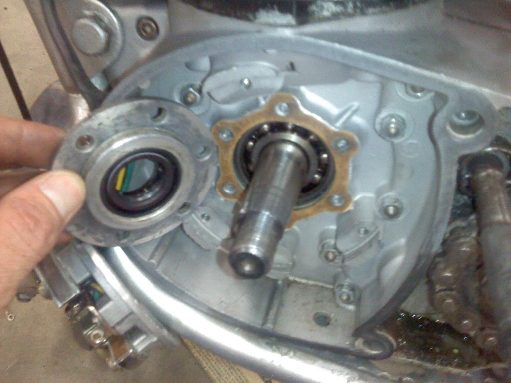

bondy Posted July 1, 2014 Report Share Posted July 1, 2014 hello saw miller the later crank seal holders look like these. Quote Link to comment Share on other sites More sharing options...

saw miller Posted July 2, 2014 Author Report Share Posted July 2, 2014 Installed a new set of stator side crank seals. Swapped carb from the other bike. Same scenario. When I get the air screw set where it pulls good off the bottom, 1/2 turn on 1 carb and 1.1 turns on the other carb, she wants to run away. Rode the bike for an hour or so and it seems to be getting hotter than it should. Running 110 octane race fuel. 52 to 1 golden spectro. Sprayed carb cleaner around the intake and the base of the head again with the engine running an revving. No luck. This should not be this difficult. Attached is a picture of the stator side seal plate. Tripp Quote Link to comment Share on other sites More sharing options...
