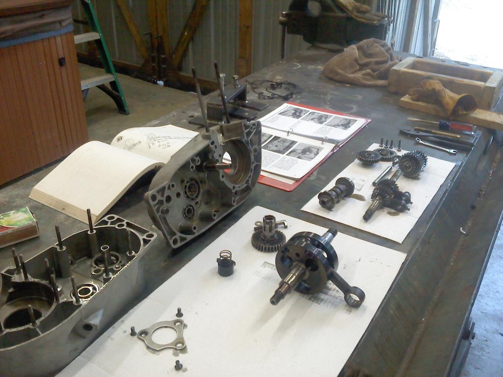

saw miller Posted July 13, 2014 Author Report Share Posted July 13, 2014 Started breaking down the sherpa today. The stator side inner bearing race is spinning on the crank shaft. The plot thickens. The bottom end kit arrived from Hugh's . Time to heat the cases and see if they will separate. Tripp Quote Link to comment Share on other sites More sharing options...

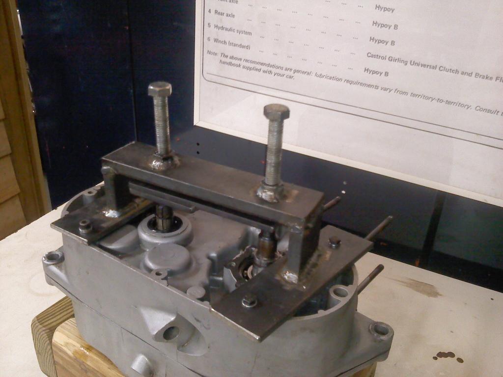

saw miller Posted July 13, 2014 Author Report Share Posted July 13, 2014 Built a case separator afternoon. I attached it to the cases and heated them on a gas grill. The separator worked like a charm. The stator side of the crankshaft seems to have issues. I can easily slide the old and new bearing on and off the shaft without heating the bearing. In fact all three bearings stayed in the cases when I separated them. Great fit in the cases. Bad fit on the shafts. Seems that I need to have the crank looked at. May ship it to Hugh's. Tripp 1 Quote Link to comment Share on other sites More sharing options...
saw miller Posted August 27, 2014 Author Report Share Posted August 27, 2014 Split the cases and rebuilt the bottom end. Had the crank done by Hugh's. New seals and bearings throughout. New rings etc. Runs great. Blip the throttle hard twice in neutral and she runs away. Swapped in the carb from the other sherpa and it does the same thing. What next? I am at a dead end. Tripp Quote Link to comment Share on other sites More sharing options...
