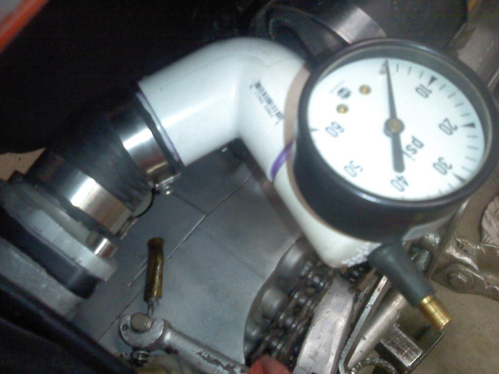

johnjsy Posted September 2, 2014 Report Share Posted September 2, 2014 Hi again Tripp,the seals I get from Simply Bearings in Lancashire,U.K. & phone number is --01942-269-837-- you may have to a country code from where you are,I think it is 44 ,best check that. They are pricey at £9.11 each!! I would also like to mention that I now always use C3 bearings on a crankshaft when re-assembling. This is a greater clearance bearing & I think worth having. The last ones I used were SKF Explorer 6205/C3 ,they are only a few pennies more than standard ones. Now back to your problem.I have been turning over a few ideas in my mind over the week end & think to try something a little different.With the motor assembled to try pressurising it! Not too difficult,a well known way of finding any leakage.Ready? Piston at B D C to uncover all ports,spark plug in & tighten down. Next, cut a piece of steel or alloy about 3/16 thick to cover the exhaust port with a good gasket. There must be no leaks here to get meaningful readings. Next,do the same for the inlet manifold but drill a hole to fit in a Schrader valve from an old inner tube . Also you need to connect here a low pressure gauge ( from an old compressor) ? To monitor the pressure in the motor. Now put in about 6 or 7 LBS of pressure,no more than that as the seals would let go. The pressure should hold for several minutes, if it goes down too quickly,you need to see where from. If the pressure holds,it must be a carb: issue. I hope this helps, & apologies for a rather long reply, John. So Quote Link to comment Share on other sites More sharing options...
johnjsy Posted September 3, 2014 Report Share Posted September 3, 2014 Hi again Tripp,apologies & correction to what I wrote yesterday. The Schrader valve & take off for a pressure gauge needs to go onto the exhaust blank plate. With the piston down the inlet is effectively closed ! You could make the pressure inlet through an old spark plug,break out the ceramic centre & weld in a piece of tube then a top piece to make a T piece. Air in on one side,pressure gauge on the other. I have to stop here, evening meal is on the table. John. Quote Link to comment Share on other sites More sharing options...

saw miller Posted September 5, 2014 Author Report Share Posted September 5, 2014 Thanks everyone for your help. I finally seem to be getting somewhere. I built a pressure tester and block off plate for the exhaust and it worked great. Loosing air at the base of the cylinder at the case seams. I hope to work on it some today. Thanks again Tripp 2 Quote Link to comment Share on other sites More sharing options...

saw miller Posted September 8, 2014 Author Report Share Posted September 8, 2014 Got the bottom end buttoned up. She holds pressure when cold. After warming up the head leaks terribly. This is a non gasket head. Re torqued multiple times. Throttle is still hanging. Guess it's getting air from the head. Any suggestions. Thanks, Tripp Quote Link to comment Share on other sites More sharing options...
